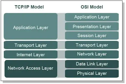

The answer is: the ISO-OSI stack.
OSI stands for Open Systems Interconnection (ISO is the International Standardization Organization), and it's a model which defines the structure used to transmit data between every kind of devices. Each level is a different abstraction layer, and adds rules or details that define the communication protocol.
While Internet (excluding things that are commonly associated with it, like HTTP) belongs to the upper layers (the Network layer), serial communication is just a way to define the Physical layer.
This is the OSI model stack, compared with the TCP/IP model used for Internet: you can see that Internet is defined at the network level, while the serial protocol (in strict sense, not the implementation) is defined by the physical layer, at the base of the stack.

Ethernet and WiFi are examples of protocols that can work as Network Access Layer, providing the physical medium and the basic transmission rules (like the encoding of symbols) for the Internet connection.
Other protocols used at different layers of the stack are, as mentioned, TCP, UDP, HTTP and many others.
