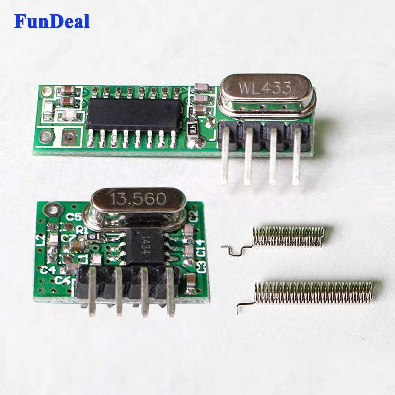

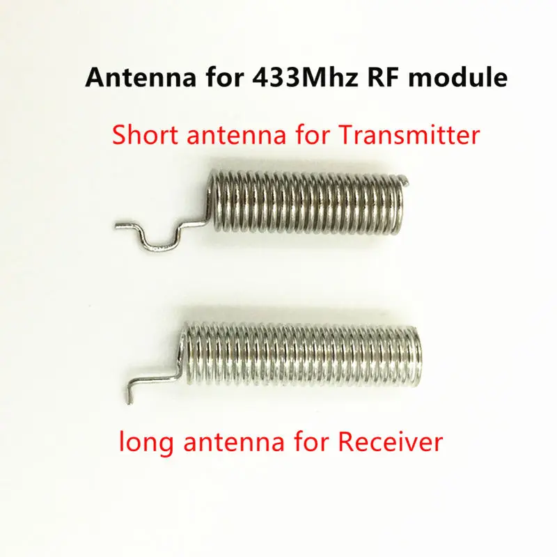

433 MHz transmitting and receiving unit are equipped with those antennas AntennaP Picture This are the 433 MHz Receiving and transmitting Units: 433 MHz Superheteodyn I want to achieve approximately 10 Meters transmitting distance from the manhole cover to the receiving unit.

    The 433 MHz radio you link is a much less robust design using a crude modulation scheme, operating at lower transmit power (perhaps limited by regulation) and with a less sophisticated receiver. No conventional radio will transmit "through" an iron manhole cover, so any path you are getting is either around, or through holes in it. – Chris Stratton Jun 17 '17 at 23:30

    We get so many questions of the nature "I found this 433MHz module in a packet of corn flakes but it turns out it has really poor range". The reason why might just be that the module itself is complete crap - you get what you pay for. – Lundin Jun 19 '17 at 06:20
  • The ESP8266 Module comes at nearly the same price as the 433 MHz modules ... 2€... so my questions was why is the 2€ 2,4Ghz signal maker better than the 2 € 433MHz signal maker..... what high quality 433 MHz Equipment would you recommend for arduino/raspberry projects? – Peter S Jun 28 '17 at 17:02

The antennas that you are using for the 433 MHz link are very marginal. While there may be regulatory issues at play, if you can increase the gain of both antennas, you would see far better performance on the 433 MHz link.
At the very least, build a 15 dBi gain yagi antenna for the receiver and point it at the transmitter.

  • I'm going to try a simple 173mm antenna to see if that changes anything. Any recommendations on good professional 433 MHz Modules for those kind of endeavours? I can only find the classic Chinese stuff. – Peter S Jun 18 '17 at 15:09
    If you use that type of antenna, make certain it has an equal radius ground plane. It should be oriented in the same axial direction as the transmitter antenna. – Glenn W9IQ Jun 19 '17 at 01:38
  • I added a simple 173mm antenna to the transmitting and the receiving unit and now I reach the same distance as with the 2,4GHz signal. – Peter S Jun 28 '17 at 16:58
