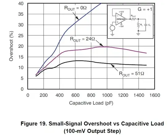

You have a fair bit of capacitive loading on the op-amp from the scope input and coax.
As @KevenWhite said above in a comment, you should add something like 51\$\Omega\$ in series with the op-amp output (right at the output) if you want to use a direct x1 connection to your scope and further connections to the rest of your system.
As far as what might be triggering the impulses, look for switching power supplies (including possibly a brick on the scope itself- even a Tek scope- it happens) and move any cell phones well away from your lashup.
Spehro Pefhany
  • 376,485
  • 842
    Notice OP changed what op-amp they said they're using, and the new one has more overshoot than the OPA140 with 50 ohms between it and a capacitive load. – The Photon Jun 17 '17 at 04:03
