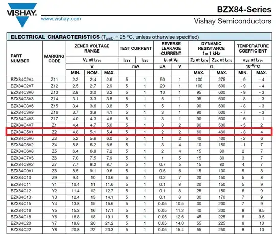

Well, like resistors and capacitors, zener diode voltage values tend to follow a range of preferred numbers such as: -
So, quite often you'll find 4.3 volt, 4.7 volt, 5.1 volt, 5.6 volt zener diodes etc..
As an aside, the 5.1 volt zener diode in several supplier ranges has the lowest temperature coefficient of voltage change with temperature: -
So, if you had asked why a lot of designs use 5.1 volt zeners I would say it is down to physics.

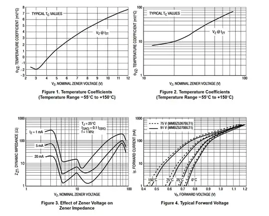

As Andy said, the available zeners are forced into the E24 series, like other components. This is done by fiddling with the physics- lower voltage (less than about 5V) are actually Zener diodes, and higher voltage diodes are avalanche diodes. The avalanche diodes work a lot better (in terms of having a sharp voltage-current 'knee'). Here are some characteristic curves from Onsemi that show the variation of characteristics with zener voltage (which they show as a continuous variable): enter image description here
Note that zener impedance is plotted on a lot-log graph- the impedance of a ~3V zener at 5mA is about 80 ohms, whereas that of a 10V zener is more like 8 ohms. So if we use a 400 ohm resistor on the former (from a 5V supply). If we similarly use a 16.7V supply and a 10V zener with 1.33K in series, the percentage regulation is more than 25x better with the latter. So lower voltage zeners are pretty useless.
There is one niche where the zener voltage that is picked is based on physics, and on the above characteristics - and that is for voltage references. For many applications band-gap references have replaced zeners- they have many advantages, especially for non-critical applications- low power and low voltage operation etc. They are noisy and have other disadvantages, however those have gradually been addressed.

Zener Diodes tend to follow E24 series like Andy aka stated.The stated device to device tolerance of garden variety Zeners is 5% .When variations in temp and Zener current are factored in things can get a lot worse than 5% .The difference between 5V and 5v1 is only 2% .If you tested two bags of say 10 zeners that were bag A 5V and bag B 5V1 you might not be able to tell which bag was which .The same reasoning applies with 5% resistors.
