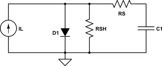

After a lot of head scratching I came up with this schematic:
Simulation: Here.
The value on ADC3 will be:
  • 5V if +12V shorts to LEVEL.
  • 1.3V if the switch is open.
  • 0.88V if the switch is closed or LEVEL shorted to ground.
ADC3 will be continuously polled as long as the relay providing the +12V to the reservoir is activated. If the value is less/larger than 1.3V -/+ 0.2V the relay providing +12V will be killed (or never activated). I may scale the resistance values to meet expected output impedance on ADC line for fast polling.
I also want the system to be safe to operate so I need to consider all the possible short scenarios:
  • 12V to GND or PGND: A high current will flow and trip a resettable fuse and µC will drop out. Next time the µC comes online the relay will be off and I need to figure out some way to detect if it shut down due to a short or normal outage.Maybe I'll use a bit in EEPROM to toggle "pump on/off" and if pump was on when it reset it's likely it was a short.
  • 12V to LEVEL: ADC3 will go to 5V and the 5V rail is protected by the diode.
  • GND or PGND to LEVEL: Same effect as if the switch was actuated. ADC3 will go 0.88V and pump will be killed with "Low water level" message.
