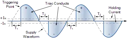

Microcontroller: If you have a microntroller already in your design then all that is needed is to have a zero crossing circuit input wired into a digital I/O port. When the zero crossing circuit is triggered you'll use a timer internal to the microcontroller to drive the OK1 opto-TRIAC high after a certain amount of time into the mains half cycle. The output waveform will look something like this.
Triac triggering
Analog: This one is relatively simple, you will use some resistors and capacitors along with a DIAC as the time delay rather than the microcontroller to trigger the TRIAC at different times in the half cycle. Here is an excellent application note from littlefuse detailing this circuit design. The output will look the same as above. Below is probably the simplest example of an analog dimmer circuit, with R1 indicating a 250K potentiometer.enter image description here
