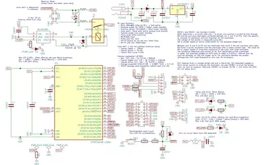

The moisture is measured using a resistive voltage divider where the soil is seen as a resistors. The temperature is measured using a thermistor. And the overflow will be detected by large electrodes in the catchment tray under the pot if water ever makes it's way there, they will short out.
The pump will be driven by a 5V relay with 125R coil resistance (40mA, 200mW). The water level sensor will be a floating ring that will actuate a microswitch when the level becomes too low. The microswitch is NO and shorts to ground when closed. The internal pullup of INT1 pin will keep the signal high when the switch is open. The IRQ handler for INT1 will do debouncing.
I have two main connectors, P2 which goes to the pot and houses the overflow, temperature and moisture probes, and P1 which goes to the pump and has the water level sensor.
Circuit schematic:
Schematic
I'm not sure about the resistor values for the LEDs yet, they're calculated for max brightness from the data sheets but I might go dimmer depending on how bright that is. I really have no idea. I'll adjust that when I have everything in my hand.
I attempted an estimate of the power drain from the regulator and I should be well within the tolerances for not needing a heat sink even at maximal draw. However typically the micro will probe the soil and if it is too dry (every 4-5 days) it will water it. Then it will go back into sleep mode for 4 hours. So the on-time is really short, around 20 seconds when it actually runs the pump compared to 4 hours sleep.
The MIC94090 (datasheet) is a high side load switch with 1.2A max continuous current. Do I need the freewheeling diode with this IC?
Should I add a small cap from LEVEL_ALERT to GND? I'm unsure about D2, do I need it? Is it harmful?
C1 is added because I'm concerned about the voltage dropping when the pump activates. I'm not sure how to calculate the drop, or if it is even a thing so I would appreciate some guidance on this. D1 is an isolation diode to try to prevent the voltage drop (if there is one) from dropping out the regulator.
I recon the internal RC oscillator divided down to 1 MHz will be sufficient for my application. 10 minutes this way or that way won't kill the plant.
The micro will be running a PID to control the duration of the pump based on how often it has to water. It will also do some low frequency data logging to EEPROM which can be read from UART. I'll do the math to make sure I don't exceed the write cycles in my lifetime.
I have not yet sourced all components or decided on which pump I'm going to use.

I'm concerned about the routing of the ~LEVEL_ALERT signal, I couldn't manage a layout where the I could ever get a decent routing for it. I'm also concerned if the possibly large current in wires 3 and 4 of P1 may induce a current in the ~LEVEL_ALERT wire running parallel to them, which wrongly causes the µC to stop the pump.
I've tried my best to do a decent job at both schematic design and layout. Do you guys believe that this will work as intended?

  • No show stoppers that I can see but two minor points - 1) Set the LED resistors for ~ 5 mA, the difference between that and 20 mA is barely noticeable and the max current drops with temperature, if this is sitting in the sun (as plants often do) then they could get quite hot and not cope with the max current. 2) (this is very opinion based) From a style point of view the schematic lacks any real flow, to work out how things are connected you have to hunt for the signal names. Named signals have their place but where practical without adding excessive mess connect the parts directly. – Andrew Jun 12 '17 at 16:05

You've made a great effort, and I see no reason it won't work. I have some comments though:
  1. You've chosen an Atmeg168-20AU but appear to be using the internal RC clock, with external ICSP for programming. Why would you use a $3 micro when you can buy a whole board laid out (Arduino Nano) with both a bootloader and ICSP support built in. You could lay out your PCB using the Nano as a solder in place component, and get a better (low power controller, more Flash, more RAM, Power regulator, USB serial IF, LEDs and reset switch) solution for about $3 on Ebay. You don't have to use the Arduino environment to program it, you can overwrite the bootloader, so there does not appear to be any downside. The PCB complexity would then be significantly reduced with no loss of functionality or choices for the project.
  2. Your Level Alarm and Moist signals are raw I/O pins taken off board. I'm always against taking unprotected I/O pins off board into wiring, there is always risk where a short might blow your I/O structure or controller. In this case your connector has both a raw I/O pin and 12 V in it for the Level Alarm.
  3. D3 does not need to be Schottky. D2 does not net to be Schottky, and in all probability is not required at all (assuming your pump is a submersible BLDC type).

    @IanBland is on the money. This is recreation and learning for me, I already have an Arduino Uno board and 250VAC relay modules for it. I can hook it all up and have it running, but that's not why I'm doing this. :) Nr2 is a very good point, I didn't think about that. Do you think the avr's internal ESD diodes would be enough to handle a short? Or should I add a Schottky to Vcc? By resistor, you mean a current limiting resistor like a hundred Ohm or something? – Emily L. Jun 12 '17 at 00:47
    That, and I'll take any excuse I can to get my soldering iron out :) – Emily L. Jun 12 '17 at 00:51
  • Personally I don't like anything that's near the outside world to be expected to handle a short. Especially when there's water about. A simple resistor will reduce fault current and you can use a high value if your input is buffered. 100R at 12V is 120mA, and 1.44W across the resistor... – Ian Bland Jun 12 '17 at 01:19
  • Since digital input pins are essentially multiple CMOS inputs the series resistor can be quite high.... 10k or more. Analog inputs can benefit from protected buffers. Digital outputs are typically more hardy, though it's advisable to only sink current IMO. I understand the ops penchant to learn, however when it's your first attempt at a microcontroller with SM components it sets the error potential a bit high. It's more challenging if you have to debug PCB, schematic and software all at once. It's worth starting with a known base (Arduino) and run simple test code first. – Jack Creasey Jun 12 '17 at 03:55

    Actually now that I think of it, I'm more worried of +12V shorting to PGND or GND than `LEVEL_ALERT`. `LEVEL_ALERT` is a high impedance input on the µC. I think I'm going to have to add a fuse of some kind. – Emily L. Jun 13 '17 at 15:37
