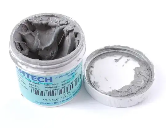

Here is some Asian-origin (real) solder paste:
As you can see, the alloy (Tin 63%/Lead 37%) is specified as well as the ball size 25-45um diameter. Most lead-free alloys are mostly tin, with a bit of copper and possibly other metals mixed in. There is a tin-bismuth alloy for the big spenders. It looks like a grey paste and under the microscope you can easily see that it is composed of tiny balls in a matrix of flux.

Solder paste photo (from Adafruit):
