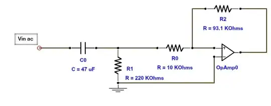

I am using a 47uF 10V SMD capacitor (GRM31CR61A476KE15L) mainly for DC blocking. But it make a phase shift on the signal, we can deal with this phase as long as it remain constant(hence the capacitance is constant too). Vin 50Hz maximum = 1.5V r.m.s , Dc offset= 0.5V After 60 days the performance of the circuit has degraded, the capacitance has been reduced to 35uF. By accident I have soldered it again and the capacitance return to 44uF (which is in the tolerance range +/- 10%). I read about this and found this page, talking about aging in high dielectric constant capacitors and the curing occur by temperature when soldering.

  • That link shows variation, But very less (<5%) for aging for even 2000+ Hours. For 60 days - 1440 hours capacitance is 35uF (~25% reduction). This is not related to aging i guess. Did you considered DC characteristics of this capacitor. Are you really sure due to aging only Capacitance is reduced from 47uF to 35uF with in 60 days? – user19579 Jun 05 '17 at 06:08
  • how did you solder these ? within specs? Murata X5R's with C>10uF have a ~50 second time constant and a great deal of memory (double electric effect) how you measured it may affect accuracy of readings. Solder temperature can also affect barium Titanite crystal alignment and C value. X5R is not recommended as a stable RC filter time constant but great for supply decoupling due to many sensitivity factors include DC voltage. – Tony Stewart EE75 Jun 05 '17 at 06:34
  • @user19579, I checked the DC characteristics, it doesn't show any much variation in 0.5V. I am not sure it is due to aging, that is my guess. But it supported by the curing occurred after re-soldering. BTW the operating temperature of the device is about 40-50C – Ashraf Almubarak Jun 05 '17 at 07:25
  • @TonyStewart.EEsince'75 , I used solder iron, temperature is 350C for ~1 second. I measured the capacitance immediately after soldering. But I installed the device in a calibration bench (which took more than 1 min at least), and the performance has changed. – Ashraf Almubarak Jun 05 '17 at 07:27

You must pick your capacitor technology bearing in mind your intended use.
X5R (Or worse Y5V) is not really the smart choice for filters (Which is what you have if you care about phase shift thru the cap), apart from anything else you will have built a voltage controlled phase shift network as applied DC across that cap will cause SIGNIFICANT changes in value (This gets much worse with smaller case sizes).
C0G is generally ok for this sort of thing, but you will struggle with finding more then about 100nF or so. The other option is film or maybe a bipolar electrolytic (If going here make the value LARGE, so the phase shift is negligible over any reasonable amount of drift).
Dan Mills
  • 17,266
  • 38
  • Could you please explain how the voltage controlled phase shift network work? And for electrolytic capacitor, will it maintain its capacitance for longer period? I know it is susceptible to dry-out – Ashraf Almubarak Jun 06 '17 at 05:11
    If you build an HP filter network with a cap that has significant variation with applied voltage (like say a small package Y5V will tend to) then changing the DC bias point will change the capacitance and thus vary the corner frequency and phase shift. – Dan Mills Jun 06 '17 at 09:41
    The usual trick for a DC removal filter where phase matters is to make the corner frequency very much lower then the lowest frequency of interest and thus minimise the effect on the phase of component drift. It is not that electrolytics do not drift, it is that you can get very long time constants so as to put the corner suitably low, if you make the corner frequency 1% of the lowest frequency of interest then a 10% change in capacitance is a very small phase shift. – Dan Mills Jun 06 '17 at 09:42
    Another option would be an opamp integrator wrapped around your input amp to cancel the DC, use a megaohm or so of resistor with a good quality film or tantalum cap, and a jfet opamp. This effectively forms a capacitor multiplier allowing the use of a large C0G wile still giving a usefully low corner frequency. – Dan Mills Jun 06 '17 at 09:44
  • The corner frequency of this circuit is 0.33Hz but I had another circuit almost the same configuration and affect the whole performance has a corner frequency of 2Hz. I will solve it by this method, thank you! – Ashraf Almubarak Jun 06 '17 at 11:33
