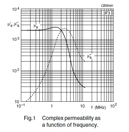

You also have to take into account the core material's ability to handle the operating frequency. Take for instance 3F3 material (one I've recently worked with): -
The solid line is the real permeability and the dotted line is effectively the losses. For this material I would want to operate a power application at no greater than 1 MHz - there will be significant warming of the core at this frequency but it should be OK. However, for an inductor, to remain stable, I wouldn't operate it at a frequency greater than about 300 kHz and this is to avoid warming the core too much. Warming the core will change the permeability and alter the inductance value: -
