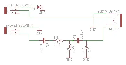

From my testing, the iPhone seems to need some capacitance in the circuit for it to detect a microphone.
I used a variation of the schematic found at http://www.creativedistraction.com/demos/sensor-data-to-iphone-through-the-headphone-jack-using-arduino/ and was successfully able to get audio into my iPhone.
This is what my schematic looked like for hooking up my iPhone to a Baofeng UV5R radio:
Schematic
I've put the Eagle files up for this here: https://github.com/johnboiles/BaofengUV5R-TRRS
UPDATE: @jose.angel.jimenez in the comments says the capacitance isn't necessary. That may well be. My testing wasn't the most scientific. Still, this was the circuit that definitely worked best for me.

Impedance (the iPhone mic input) is a little trickier than straight DC resistance. Impedance line-matching has always involved a few passive components (cap's and/or coils). johnboiles' schematic uses some series RC for (I assume) signal matching/conditioning to the iPhone's mic input and he's apparently using the left (?) channel of the iPhone's output to feed the mic input on the ham radio(??). A 1.6Kohm resistor is a workable approximation, but isn't really impedance-matching.
