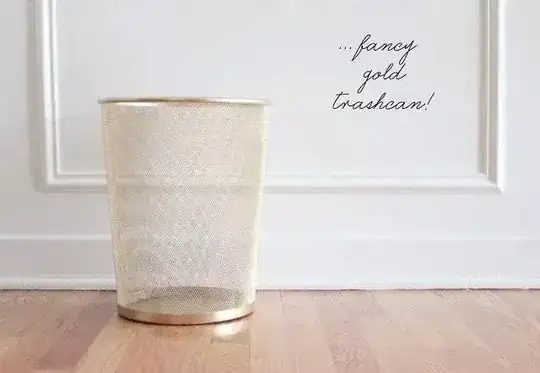

I suggest putting the whole product inside a Faraday cage, like a microwave oven, a pressure cooker, or something like that:
Also available in see-through...
Now, if you run wires through your Faraday cage, then the RF will ride on them, and you'll need to use proper feedthrough filters, and basically Do It Right, which I guess isn't the point.
