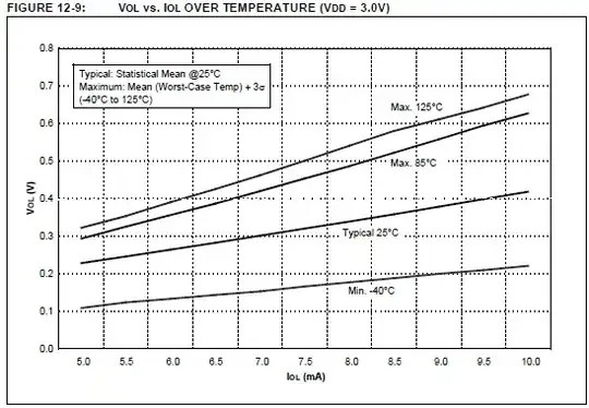

But in the final analysis, it's always a good idea to go look at the datasheet itself to see. Here's an example from the PIC12F519 (one of the cheapest parts from Microchip that still includes some internal, writable non-volatile storage for data.)
This chart shows the LOW output voltage (vertical axis) vs the LOW sinking current (horizontal axis), when the CPU is using \$V_{CC}=3\:\textrm{V}\$:
This chart shows the HIGH output voltage (vertical axis) vs the HIGH sourcing current (horizontal axis), also when the CPU is using \$V_{CC}=3\:\textrm{V}\$:
You can easily see that they don't even bother trying to show the same sinking vs sourcing current capabilities.
To read them, pick a current that is of similar magnitude on both charts (very difficult, isn't it?) Let's select \$5\:\textrm{mA}\$ on the first chart and \$4\:\textrm{mA}\$ on the second one. (About as close as we can get.) You can see that the PIC12F519 will typically drop about \$230\:\textrm{mV}\$ on the first one, suggesting an internal resistance of about \$R_{LOW}=\frac{230\:\textrm{mV}}{5\:\textrm{mA}}\approx 46\:\Omega\$. Similarly, you can see that the PICF519 will typically drop about \$600\:\textrm{mV}\$ on the second chart, suggesting an internal resistance of about \$R_{HIGH}=\frac{600\:\textrm{mV}}{4\:\textrm{mA}}\approx 150\:\Omega\$. Not very similar. (NOTE: I've extracted data from the curves for \$25^\circ\textrm{C}\$.)
So if you were designing this particular MCU into a circuit where you wanted to directly drive a \$2\:\textrm{V}\$ LED at about \$10\:\textrm{mA}\$, which way would you wire it? It's clear that you'd have to consider LOW as ON, since that is the only way that the datasheet says you might be successful, at all, without the need for an external transistor to boost the current compliance of the output.

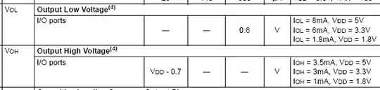

It is fairly common (although not as common as it used to be) that microcontroller output pins can sink more current in the low state than they can source in the high state. As a result, designers got used to putting LEDs, or anything else that needs a high (for a microcontroller pin) current between power and the pin instead of between ground and the pin. When the micro has symmetric source/sink capability, this is not necessary, but does no harm either.
For example, here is a snippet from the PIC 16F1459 (a reasonably recent and certainly mainstream production part) datasheet:
Note how the currents for the Output Low Voltage case are higher at the same supply voltage than for the Output High Voltage case. And, the sink currents are specified for a 600 mV rise, while the source currents for a 700 mV drop. All in all, this micro has substantially stronger low side drivers on its regular I/O pins.
