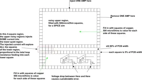

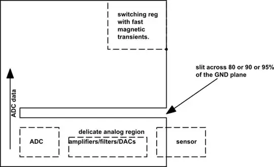

Simply introducing SLITS into the GND plane may suffice to largely keep digital/power/relay/motor trash out of the delicate analog areas. [ EDIT June 9 Showed a narrow region will achieve 12dB/square attenuation. EDIT June 2019 Remember to slit the Power Plane as well (suggested by barleyman)]
What can we predict about slit placement versus intrusive-current In point and Out point?
simulate this circuit
What to expect, as the slit intrudes into currents?
We had approximately 40 microvolts/square along bottom edge of the PCB, assuming 0.0005 Ohms/square. We can estimate the I*R voltage drop, caused by ONE AMPERE at top right of PCB, along the very bottom edge of PCB inside the analog region as simply
Slit_Atten = length of slit / entire loop length inside the sensitive region
Voltage drop at very bottom (per square) is
Voltage across slit * Slit_Atten
Math: slit is 4 squares, thus 4 * 40uV = 160uV.
Slit_Atten is 4 squares / 20 squares (entire loop periphery) = 20%.
The per_square I*R drop is 160uV * 20% = 32 uV.
This shows the value of using only NARROW regions between digital/noise and analog.
Here is another way to slit.
Voltage per square where OpAmps need quiet GND = 32 uVolts, per square. Not very quiet. What to do?
1) cut the slit further into the planes; now at 80%, go to 95% and likely get an exponential improvement in quietness; run the SPICE sim and see how

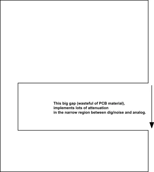

2) make the slit ----- not narrow ---- but deep, like this

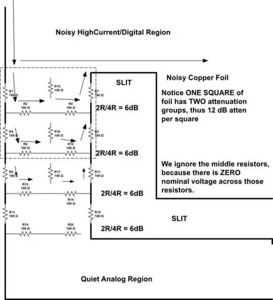

What can we predict about the attenation of "L" slits? Turns out we can predict 12 dB attenuation per square of the narrowed-region. We zoom in, and see this

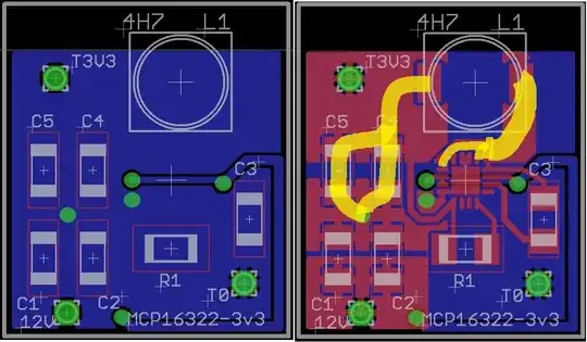

Some notes on this. As others have pointed out, current loops are not your friends. You should be aware of your high power / high speed circuits and where the power is supplied to them. Anything in-between these two points are directly in the field of fire, don't put your 16-bit ADCs between boost converter and high-power PWM controlled LEDs..
Splits or moats in ground planes can be beneficial but these get involved fast. Most important thing to remember is to NEVER EVER CROSS A SPLIT IN THE PLANE WITH A HIGH-SPEED / SENSITIVE SIGNAL LINE. Your signal lines need a return current path right next to them. So if you create a horseshoe around an ADC, you have to then route all signals around that moat as well. If you absolutely have to cross a split, you could use a local capacitor to link separate GND planes but then you're defeating the purpose of the moat in the 1st place. Presuming you've got a multi-layer board but it'd be much less painful just not to do it. Swap layers before the split to another plane that has uniform reference plane. NB this does not apply to DC or low frequency signals/loads. They're happy enough to follow path of least resistance around the moat. Don't forget you have to match splits in GND planes with matching splits in power planes!
To make this more complicated this applies to the reference plane i.e. ground plane next to the signal layer. If you've got 8 layers or more, it doesn't matter what's on L2 plane if your sensitive circuit is on L8. You can use power plane as a reference as well but often these days you have any number of power planes (5V, 3.3V, 1.8V, 1.2V, -5V, whatever) so the offending circuitry can only be referenced to the power plane it originates from.. Referencing a 1.8V PHY to 3.3V plane won't work. Unless, you know, you provide those stitching caps again between planes.
I have done high-speed ADC multiplex circuit that achieved essentially zero noise (~0.6 ADC unit) level by splitting VCC and VCCA plus GND and AGND. But I know what I'm doing and I spent time religiously mapping analogue lines and creating "islands" of related copper on the next layer and so on. Most of the time I just keep all the grounds together and mind the current loops.
Changing layers also counts as a split in the plane so you should have a matching GND via(s) nearby so the high speed return current won't have to make extra detours.
Final note: Return current follows the path of least resistance. For low frequencies that's the shortest available solid copper route that may not follow your signal/power trace. For higher frequencies its right next to the driving signal as separation increases impedance. That's why crossing planes ends in tears as you're creating discontinuity that results in reflections, radiated RF frequencies, signal integrity loss, rain of frogs and so on.
