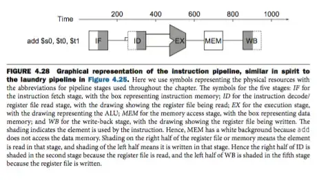

You shouldn't have to forward from writeback to decode, WB happens in the first half of the cycle and ID in the second.
This is the best image I could find on short notice, give me a minute and I will try and find the relevant image from a textbook. Alright, here are some relevant figures from Patterson & Hennessy (a pretty darn good text on computer organization, focusing on the MIPS architecture. I would recommend you get a copy):
In writeback, the register file is written to in the first half of the cycle; in instruction decode, the register file is read from in the second half of the cycle. As I understand it, this text's description of MIPS is fairly accurate. In hardware, this might be implemented with two clocks: the EX/MEM/WB stages would be driven by clock A, and IF/ID would be driven by clock B, 180º degrees out of phase (inverted). Careful design of the logic ensures that IF/ID/WB are "complete" in less than half a clock cycle.
In a simulator, you simply have to update the register file from writeback before decode is executed.
Figures from Patterson & Hennessy, Computer Organization and Design, Chapter 4.

  • Yes, I know about the write and read in reg file on the same clock cycle. However, if I write to decode early, this could cause problems if something forwards to execute right after. –  May 21 '17 at 03:53
  • You need to arrange your forwarding so that the "newest" value is the one that is forwarded, if there is a situation where multiple stages have a value that could be forwarded. Simply make sure that when there are multiple stages from which a value could be forwarded, you select from the stage with the most recent instruction. Any forwarding overrides the WB->ID, because WB->ID is not a forward, it's just regular operation. – uint128_t May 21 '17 at 03:57
