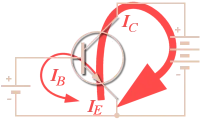

I am completely unable to understand the current direction in npn transistor. figure 1
in figure 1, the red arrow indicates the electron flow(which is from emitter terminal to collector terminal). thus according to the convention, the current flow is just opposite to the direction of electron flow. therefore the current must flow from collector terminal to emitter in npn trnasistor. enter image description here
but nothing like that happens. instead, the current flows from emitter terminal to collector terminal(that is in the same direction of electron flow). why is it so? why does this happen?

Thanks for pointing out where you got the diagram that you added to your question. (You probably should now include it inside your question, rather than leave it as a comment to another answer you got.) Here's the diagram you were asking about:
I think the diagram was trying to illustrate the conventional current flow on the left side and the electron flow on the right side. But they made a mistake and used a PNP schematic symbol on the left when they should have stayed with the NPN schematic symbol for both cases. If you replace the PNP on the left with an NPN symbol, then the diagram makes sense in the context of illustrating conventional current directions on the left side and electron current directions on the right.

Someone has succesfully feeded to you some total disiformation.
Everything is not bullshit.Your this image
shows the flowing directions of the electrons and also shows which loop has higher flow rate electrons per second, if the transistor is used as usually (= the base current controls the collector current)
But the direction of the current is the opposite of your arrows.
The general agreement on "the current has the opposite direction of the electron flow" should be used also here. That agreement was done when there was no evidence of the existence of so called electrons. Instead, the electric current seemed to carry metal through liquids. That phenomena was quite believable, so the direction of the current was nailed to be the opposite of the direction of the electrons. When the electrons finally were accepted due the new accurate measurements and plausible theories, the electric industry was already so massive that the current direction convention had become untouchable.
The arrow in the emitter tells the current direction. Hopefully you have noticed that the currents in the transistor come from the external sources. The transistor is only a way to those currents, altough quite complex one when compared to wires or resistors.
