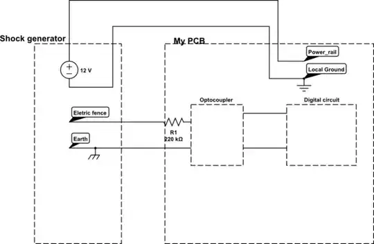

I am designing a circuit that will sense an electric fence shock generator.
In my first prototype, it worked very well, except in the time the shock generator creates a spark, when it produces a lot of interference in my sense circuit. It seems to me that the wires that connect my circuit with the generator are carrying a lot of noise inside my PCB and I am looking for advices for how to reduce it. More details about my circuit below:
Schematic

The PCB has two pairs of wire connections: The power supply, a 12V sourced by the shock generator circuit and the wires that came from the electric fence, with are connected to an optocoupler.
The signal generated by the optocoupler is processed by a digital circuit, which is experiencing a lot of false clocks and triggering in the moment a spark is generated in the fence.

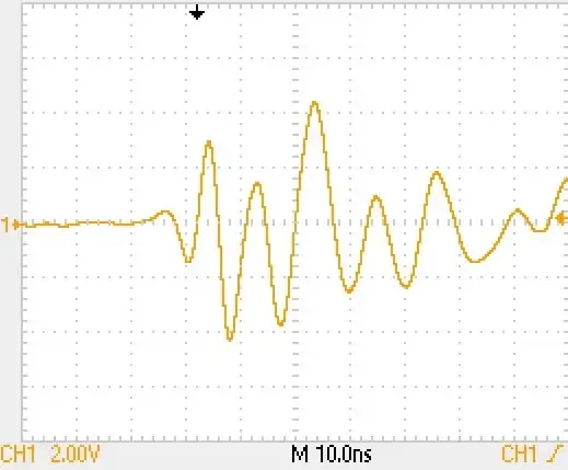

I tried to start an investigation about what was happening and I almost concluded that the noise has been carried by the wires, because I put a scope probe with both terminals shorted together in the nearby of the wires and I found this: Signal in the scope, when probe's terminals were shorted together
I have repeated this test far away from the wires, but I did not obtained this results.

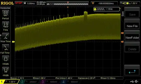

The image below is the noise in a track which work as a clock in the digital block:
As the image above indicates, the circuit has a lot of false clock that are may causing the erros I have mentioned. However, I feel I can not trust 100% in my scope in such high frequency. As a counter test, I tried to watch the voltage in the supply pins of the microcontroller of the shock generator (this part is working very well) and I obtained the following image:
If this was the real voltage across the supply pins of the microcontroller, I think it would burn in less than one second, as its maximum voltage was 5.5V and it has spikes grater than 8V (maximum values not shown in the scope snapshot).
Anyway, it seems to me that I can trust that I have a lot of noise inside my PCB, but not generating so much voltage as it is showed in the images above.

    FWIW, that construction is about as poor as possible for EMC. And sparks are one of the worst possible interference sources. Both conducted and radiated coupling are likely with that design. – The Photon May 19 '17 at 16:39

  • @ThePhoton, can you give me some adivices about how to improve the EMC performance of my PCB? What does you think about my changes for the next version, which I mentioned in the end of the original post? – Luis Possatti May 19 '17 at 18:06

  • Connect the ground clip of your scope probe to the probe tip and wave it around your DUT while arcing, you'll more than likely see similar results – sstobbe May 19 '17 at 18:16

This is a small partial discharge pulse measured using the above method on 50 Ohm coax terminated by 50 Ohms, similar to a small fence discharge or a Hipot bug zap. I used an old LeCroy scope to capture the image. The 1ns rise time is limited only by the scope.

That PCB is single layer. Using thru-hold components and a double-sided PCB, I bet you can implement solid-one-side-GNDplane.
Your first waveforms show ringing in 100MHz (10 nanosecond) region. That could be scope-probe. On the other hand, at 100MHz, a plane should produce 8.6dB * sqrt(100MHz / 4MHz) = 8.6dB * 5 = 43dB attenuation of magnetic-field injected interferers.

  • Hey guys and @ThePhoton, the 1st waveform is a shorted 10:1 probe probably rated for 200MHz. The long ground wire loop and cable capacitance results in this 100Mhz ringing into 10 MOhm load. Good signal, bad noise. It should look like my waveform. – Tony Stewart EE75 May 19 '17 at 23:23
