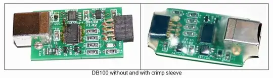

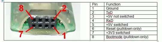

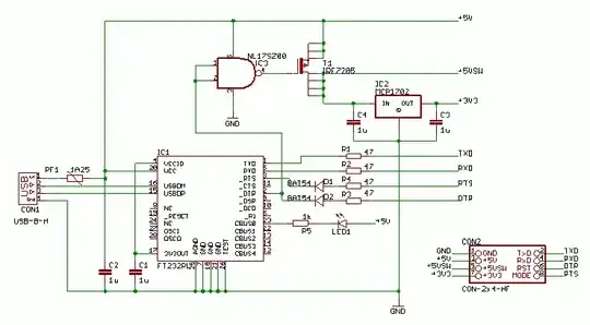

Since no standard seemed to exist, I made my own choice: a 2x4 right-angled pin header for the target board, and a ditto female connector for the 'programmer' board. The programmer has an FT232RL or similar, a 5V->3.3V regulator, and a switch to disable the power to the target board (required to force the target chip into programming mode when the reset pin has been re-purposed as GPIO).
connector pinout
programmer ('dongle') circuit diagram
Programmer with a minimally populated LPC1114 target board.
