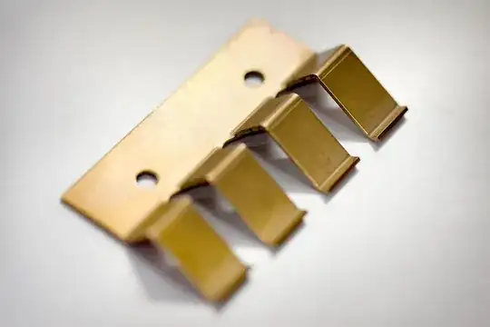

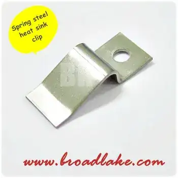

A better solution to mount the devices to the heat-sink using a softer mechanical connection that allows an appropriate amount of slippage between the device and the heat-sink. For example, heat-sink-clamps.
Use a sufficient amount of heat-sink compound to act as a lubricant to ease the slippage while maintaining the appropriate amount of thermal contact.
