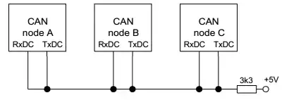

To achieve this, you need to know a little about what the transceiver does. Like most transceivers, they can output a high or a low to the bus (representing 1 and 0), but the 0 can dominate a 1. I.E. If two transceivers try to speak at the same time, and one is saying 1 and the other is saying 0, then the 0 will win. We can re-create the same situation simply using diodes:
Simple CAN
See the Seimens application note AP2921: On-Board Communication via CAN without Transceiver
But here's something even more interesting: The PIC actually has hardware support for transceiverless CAN!
CIOCON Register
You can configure the CAN TX pin so that is behaves in exactly the same way as the transceiver. This means you can wire up the CAN bus without the diodes. You'll still need the resistor though.
Simpler CAN

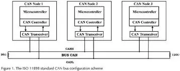

Yes, you need a tranceiver. The CAN pins on the micro are receive and transmit. The CAN bus itself uses a twisted-pair with differential signalling on two wires called HIGH and LOW.
One of the transceiver's jobs is to take the logic level you present on the TX pin an turn it into CAN bus signals:
  • a logic '1' is represented by not driving the bus, so the HIGH and LOW lines "float" to 2.5V - called a "recessive bit" in CAN terminology.
  • a logic '0' is represented by driving the HIGH line high and the LOW line low - called a "dominant bit" as it will override any recessive bits being transmitted.
The other is to take what is on the bus, and turn it back into a logic-level to send back from the RX pin to your micro.

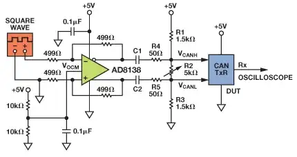

Analog devices has an example CAN transceiver circuit using a differential amplifier.
I haven't tried this, am just aware of it. Also interested if it could be implemented with an op-amp
analog's circuit
The advantages of using dedicated IC CAN transceiver is they will handle arbitration for you and you don't have to worry about interfering with the bus. If you are only observing the bus and it's not a fault critical environment, the circuit may be fine. While the mcp2551 is very popular, there are many options for interface chips.
