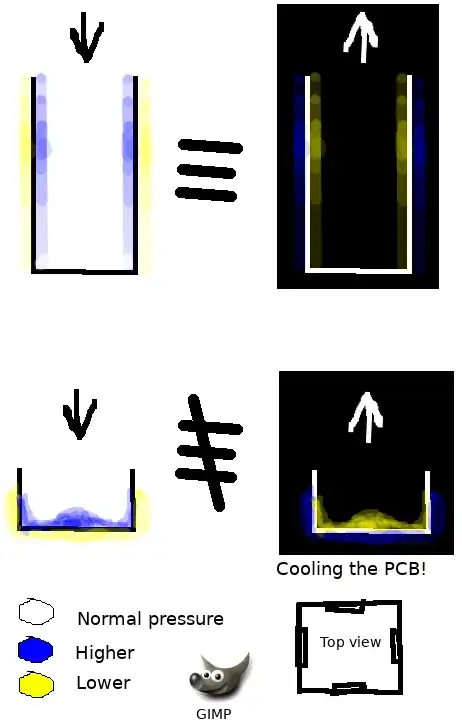

The pressure pattern will differ.
When blowing into, the pressure on heatsink surface (parallel to blades) will be higher, which means higher thermal conductivity on the surface.
When sucked through fins, the pressure on the fins' surface orthogonal to the air flux will be higher.
So I think the correct airflow direction depends on the heatsink's dimension ratios & weighting them with thermal spreading pattern. Empirically one could say that when its ampleness is much larger then its depth, definitely blow through is better.
Addition after andresgongora's comment...
Think the air pressure as voltage and air velocity as current, the obstacles orthogonal to flow as resistance, the resulting convection of heat as power. Or think the pressure the mass interacts with heat per unit time, which is being refreshed by airflow rate.
So the pressure pattern won't give an exact picture of what is happening there, full convection pattern will be complicated but it gives a good idea about the better direction of airflow.

  • If it is wider than deeper, shouldn't it be sucking? And when deeper than wider then blowing? I think I don't get it, could you please elaborate? After all, it's not pressure we are after, but airflow. – andresgongora May 17 '17 at 09:03
  • @andresgongora see the addition. – Ayhan May 17 '17 at 14:40
