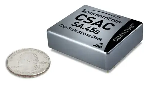

This device may be of help:
It's a Chip Scale Atomic Clock which outputs a 10MHz square wave with 1.5 \$\times\$ 10\$^{-10}\$ accuracy, several orders of magnitude more accurate than TCXO (Temperature Controlled Crystal Oscillator). Tune your oscillator so that you get 10 000 000 pulses from the CSAC over 32 768 cycles of your crystal.
Only 1500 dollar, which sounds like a bargain to me. (Your own fault, you should have mentioned a budget :-))

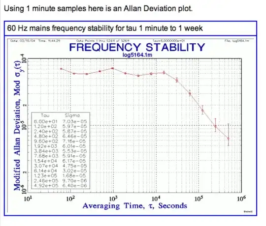

enter image description here Never-the-less barring daily transients for load cycles the phase and frequency the 50/60Hz grid is extremely stable. Only measurement errors from averaging with glitches rather than using precision TI counts and filtering out glitches, would improve the results. Client overloads can also upset the results when their phase is out of sync when selling power to a neighbouring utility.
Utilities need to stay in sync with their clients nation wide and around the world as best as possible to avoid obvious instabilities. There are significant COntrol System stability improvements to prevent over-reaction to EMP, Solar storms and grid lock in the last decade.. My observations were limited to late 70's when signals were even more stable than this plot. A lot has happened with a move towards HVDC grids which avoid the obvious PLL phase locked constraints of power sharing across a continent. But acceptable tolerances to customers are loose compared to the grid sharing nature of gigawatt PLL's in current sharing mode. ( I can get more theory but it is too techy )
The noisy graph shown by Stevenh is commented by author to have excess noise short term due to measurement error, which can be eliminated with an active BPF at 50 (60) Hz. THey go on to say..
"On short term (seconds to hours), several mechanisms are employed that continuously try to keep the frequency as close as possible to 50.0000 Hz, but that do not consider the phase (i.e., clock error). As long as the deviation between the true time and the time indicated by a mains-driven clock is less than 20 seconds, observed at 8 o'clock in the morning, no further measures are taken. When that deviation exceeds 20 seconds, a correction is scheduled: during the next day (from midnight to midnight) frequency regulators in the entire zone will be set to 10 mHz higher or lower than the normal 50.0000 Hz. Ideally, this results in a correction of 17.28 seconds. The above should normally keep the deviation within about 30 seconds. Only if the deviation exceeds 60 seconds are larger corrections than 10 mHz allowed."
10mHz /50Hz = 0.2 PPM which is better stability than can be expect from 32KHz clock, so that proves it can be used easily to calibrate your clock.
