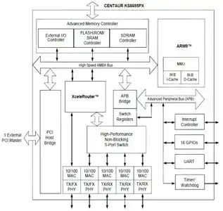

There are three solutions at least:
I'm surprised seeing this question downvoted because it addresses an architecture very popular even today. And i'm surprised seeing the Xiong's answer downvoted too because except mis-writing "PHY" instead of "SWITCH" (that could be corrected from the context, imo) he was right in full.
