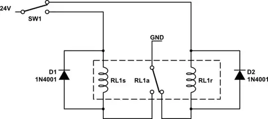

A simple latching relay circuit controlled by a switch is shown below. When SW1 is changed over, relay contacts RL1a allow a coil to be energised and the relay starts moving.
If (and it's an if as I really don't know) the coil energy is enough to change the relay over even with the contacts being broken early in the travel, it will work. The diodes are draining the energy from the coils so that makes things worse. But I know it can turn out that a circuit like this has been used for decades and is fine, depending on the relay, so I'm posting it for comments from other engineers' experience.
So that's an idea for controlling a latching relay from a changeover switch without pulling a residual current, only a transition current.
I then had an idea for switching the 'r' reset coil to a capacitor on power-off, which would discharge itself into the coil and reset the relay. But I can't see how to add that switching-with isolation in a simple way...without another relay.
It could be done with several transistors and diodes and so on. But the circuit starts to get increasingly untidy and your question doesn't give me a good enough idea of what we're trading off against here (cost, complexity, time, ability to construct etc).
I'm posting this here anyway: not as an answer but as a trigger for discussion from other contributors. I'll delete it if it proves useless in the long run.

    M .I tried this along time ago when I had thick hair .It did not work on my small DIL latching relay so I used 2 transistors to invert things so the armature had to get fully across .It worked on BC337.I was wasting some bias current so I suppose that nowdays 2 mosfets would be better. – Autistic May 12 '17 at 11:51

  • Yes, this is where it went when I sketched it out - a horrendously big circuit that must be unappealing to the OP :-) As per my answer, "your question doesn't give me a good enough idea of what we're trading off against here (cost, complexity, time, ability to construct etc)" – TonyM May 14 '17 at 08:40
  • Incidentally, the question said from the start, "So the latching relays must work on ON/OFF switches, not momentary switches" so needs some editing into one circuit – TonyM May 14 '17 at 08:42
  • @TonyM yup, But I usually go with the title if there is some ambiguity in the body of the question, specifically because other will see the title and wonder... "Ya how DO I DO THAT.." – Trevor_G May 15 '17 at 13:24
  • @TonyM, and I agree the circuit is complex. but then again, if you need to shut off a gas valve or some other critical device, complexity is not a problem. – Trevor_G May 15 '17 at 13:26
    Quite. As per my answer and comment, if we knew what his priorities were, we could design for it properly. He's not shutting off a gas valve and I suspect (complete guess) that this is to be small'n'cheap. But all good points, good Trevor :-) – TonyM May 15 '17 at 14:02
