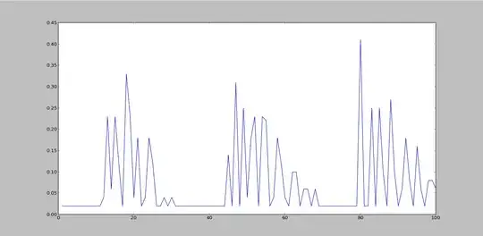

You can make a circuit utilizing an inverting op amp that will invert the PWM output. I (hastily) created one in Multisim. LED strip 1 would be receiving the red signal and LED strip 2 would be receiving your purple signal.
Crude inverting op-amp circuit
As you can see from the first chart, when the duty cycle is 80%, LED strip 2 duty cycle will be 20%. The second chart demonstrates the opposite: LED strip 1 is at 10% duty cycle and LED strip 2 is at 90%.
LED1- 80%, LED2 - 20%//LED1- 10%, LED2 - 90%
I hope this helps push you in the right direction! Good luck!!
