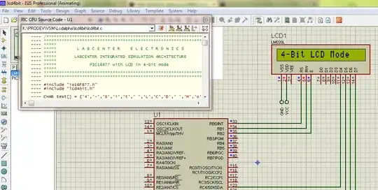

I have just downloaded the Proteus ISIS Circuit Simulator and I've noticed that in their samples, they have PIC projects based on C and they could step through the C code in the debuger.
Here is a screenshot from one of their sample videos:
their samples
But I just don't know how to specify my C source files to the simulator.
I can specify source files in assembly under Source>Add/Remove Source Files, however this does not work for C source files. I prefer C to assembly coding and I request for help or a simple tutorial on how to debug a simple C PIC project in Proteus ISIS.

These compilers each generate a debug file, if enabled in the output options. You have not mentioned your compiler, so I am going to give an example for Hi-Tech C for PIC10/12/16. Your compiler is going to generate a .cof file as well as a .hex file after the compilation, if enabled in the compiler output options.
Double click your PIC in proteus, "Edit Component" dialog will appear. It is the same window that you include your hex file, however this time you are going to include your .cof file:
Edit Component
Click "OK" after you have included, now double click on your crystal if you have any, and click and activate the box labeled "Exclude from Simulation", click "OK", do the same for the capacitors that are connected to that crystal, if any.
Now click on "Advance Simulation by one animation frame" button, shown below:
Step button
Now you can see your source code, and navigate through it via the same button above. If you cannot see the code, and your compiler is not in the list I mentioned, then unfortunately it is not supported. If you cannot see any code window, then activate it by "Debug >> PIC CPU >> Source Code". You can also see your variables with "Debug >> PIC CPU >> Variables".
