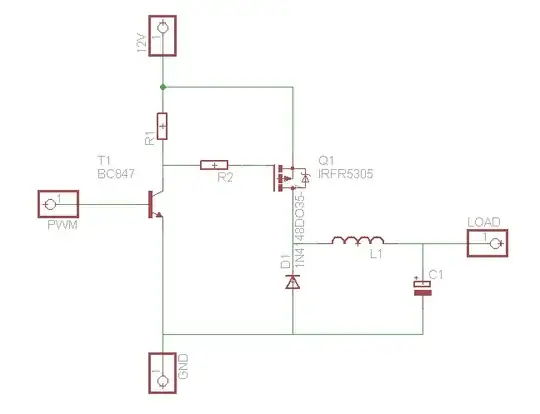

I am confused by zero crossing detection of opto-triac. I know what is the zero crossing detection or switch. (ZCS)
Zero crossing detects what is the point that wave is going to positive to negative or negative to positive.
But, I cant explain function of below circuit with help of zero crossing.
Can it control the load using PWM signal at terminal named signal? And explain How can dim the light bulb using PWM signal.
