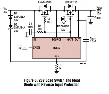

It's similar to the ideal diode controller from LT (LTC4359). If the load voltage is above the Vin voltage, then the MOSFET's intrinsic diode won't conduct. If you want a switch + ideal diode, then you have to put two transitors. enter image description here
Marko Buršič
  • 23,562
    Seems like the two back to back mosfets is the solution I'm looking for but for anyone looking to implement this, the TI chips cannot be used in this configuration according to [this thread](https://e2e.ti.com/support/power_management/power_interface/f/204/p/297508/1037204#1037204) it also explains why the LTC4359 is 3 times as expensive – Fiebbo May 08 '17 at 07:56
    Luckily there is a LTC4359 board, china made, on ebay and others . Just in case you want to experiment, unfortunately it is just up to 15A. I have also found some other company that sells ideal diode (no second transistor) with much larger MOSFET, 40V 600A. It seems that the LTC4359 can drive also MOSFET with larger gate charge (or two smaller?). IMO you should use avalanche rated MOSFETs, just in case of large kick-back voltage pulse. – Marko Buršič May 08 '17 at 08:13
