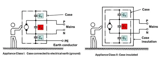

In the left hand image below the Cx and Cy noise filter capacitors connect to the metal case which is connected to mains ground (PE).
If the connection to mains ground at PE is removed then Cx and Cy form a capacitive voltage divider across the mains and the metal case is at about 1/2 Vmains. Cx and Cy are typically 1 nF and the current available is below what which is deemed a cardiac hazard by most regulations. The shock which can be received is annoying and the voltage can damage electronic equipment.
Adding a ground lead remedies the problem.
From Wikipedia image here
Providing a ground wire to eqpt metal parts will fix the above problem. This SHOULD be via the mains outlet but a wire to local ground will work much the same. There is some small risk that the wire to random ground will increase the hazard - but unlikely. Wire to power point ground should be safe.
