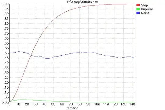

I usually take A/D readings significantly faster than they are needed and apply two of these filters cascaded. This is the digital equivalent of two R-C filters in series, and attenuates by 12 dB/octave above the rolloff frequency. However, for A/D readings it's usually more relevant to look at the filter in the time domain by considering its step response. This tells you how fast your system will see a change when the thing you are measuring changes.
To facilitate designing these filters (which only means picking FF and deciding how many of them to cascade), I use my program FILTBITS. You specify the number of shift bits for each FF in the cascaded series of filters, and it computes the step response and other values. Actually I usually run this via my wrapper script PLOTFILT. This runs FILTBITS, which makes a CSV file, then plots the CSV file. For example, here is the result of "PLOTFILT 4 4":
The two parameters to PLOTFILT mean there will be two filters cascaded of the type described above. The values of 4 indicate the number of shift bits to realize the multiply by FF. The two FF values are therefore 1/16 in this case.
The red trace is the unit step response, and is the main thing to look at. For example, this tells you that if the input changes instantaneously, the output of the combined filter will settle to 90% of the new value in 60 iterations. If you care about 95% settling time then you have to wait about 73 iterations, and for 50% settling time only 26 iterations.
The green trace shows you the output from a single full amplitude spike. This gives you some idea of the random noise suppression. It looks like no single sample will cause more than a 2.5% change in the output.
The blue trace is to give a subjective feeling of what this filter does with white noise. This is not a rigorous test since there is no guarantee what exactly the content was of the random numbers picked as the white noise input for this run of PLOTFILT. It's only to give you a rough feeling of how much it will be squashed and how smooth it is.

    Nice answer, but just two things. First: it's not necessarily lack of attention that leads to the choice of a wrong filter; in my case, I've never been taught about the difference, and the same applies to non-graduated people. So sometimes it's just ignorance. But the second: why do you cascade two first-order digital filters instead of using a higher order one? (just to understand, I'm not criticizing) – clabacchio Apr 20 '12 at 13:51
  • @clabacchio: Two cascaded single pole filters *is* a higher order one. Write the algorithm for what you consider higher order, and you'll see the same number of operations. – Olin Lathrop Apr 20 '12 at 14:00
  • Fair enough; but I was seeing it as two cascaded IIR, and in my mind it implies more complexity because of redundancy...where am I wrong? – clabacchio Apr 20 '12 at 14:01
    two cascaded single pole IIR filters are more robust to numerical issues, and easier to design, than a single 2nd-order IIR filter; the tradeoff is that with 2 cascaded stages you get a low Q (= 1/2?) filter, but in most cases that's not a huge deal. – Jason S Apr 20 '12 at 14:45
    @clabacchio: Another issue I should have mentioned is firmware implementation. You can write a single pole low pass filter subroutine once, then apply it multiple times. In fact I usually write such a subroutine to take a pointer in memory to the filter state, then have it advance the pointer so that it can be called in succession easily to realize multi-pole filters. – Olin Lathrop Apr 20 '12 at 15:03
    1. thanks very much for your answers - all of them. I decided to use this IIR Filter, but this Filter is not used as a Standard LowPass Filter, since I need to average Counter Values and compare them to detect Changes in a certain Range. since these Values van be of very different dimensions depending on Hardware I wanted to take an average in order to be able to react to these Hardware specific changes automatically. – sensslen May 21 '12 at 12:06
  • @OlinLathrop I think there is a problem with your description. With the shift inside the FILT calculation, any time there is an inflection, the output will stay constant until (NEW-FILT) > 16 or < -16. Won't this leave odd flat spots at inflections? I think the calculation and FILT should be left scaled by 16 and the shift done after the calculation to get output. Something like FILT <- FILT + FF(FILT)-NEW and then output FF(FILT) – C. Towne Springer Dec 31 '13 at 20:39
  • @user: I implement it as written, but add fraction bits to FILT as appropriate. I never said FILT is integer. It is usually fixed point. To not loose any data, you have to add Log2(1/FF) bits each filter pole. In practise you can make a tradeoff with where the noise floor is or what accuracy you care about. Note that the error you mention when using too few fraction bits is not accumulating since NEW-FILT gives you the complete error each time. – Olin Lathrop Dec 31 '13 at 20:55
  • @OlinLathrop To be precise, you wrote shift right by 4 bits on small systems, but I get your point. It works fine on fixed point, and certainly much smaller and faster than a circular buffer. – C. Towne Springer Dec 31 '13 at 22:59
  • @user: I glossed over this detail by saying *"the numbers usually need to be wider than the input value"*. In any case, it seems we basically agree. Note that fixed point doesn't necessarily mean using more bits. On a 16 bit machine you can shift a 10 bit A/D reading left 5 bit to view a word as 11.5 fixed point. All the math operations work regardless of where you think the binary point is. – Olin Lathrop Jan 01 '14 at 00:08
  • @mars: So sorry you're annoyed. I'll refund your full payment. Oh, wait... In any case, I just checked and both PLOTFILT and CSVPLOT are included in the Full Runtime release on the page linked to above. From your description I can't tell what exactly went wrong. Did the installation program succeed? Obviously you can't expect the software to run correctly if it didn't install correctly or you failed to follow any of the directions. – Olin Lathrop Dec 02 '14 at 14:49

  • If I'm reading you right, you're describing a first-order IIR filter; the value you're subtracting isn't the oldest value which is falling out, but is instead the average of the previous values. First-order IIR filters can certainly be useful, but I'm not sure what you mean when you suggest that the output is the same for all periodic signals. At a 10KHz sample rate, feeding a 100Hz square wave into a 20-stage box filter will yield a signal that rises uniformly for 20 samples, sits high for 30, drops uniformly for 20 samples, and sits low for 30. A first-order IIR filter... – supercat Aug 28 '13 at 15:31
  • ...will yield a wave which sharply starts rising and gradually levels off near (but not at) the input maximum, then sharply starts falling and gradually levels off near (but not at) the input minimum. Very different behavior. – supercat Aug 28 '13 at 15:32
  • You're right, I was confusing two kinds of filter. This is indeed a first-order IIR. I'm changing my answer to match. Thanks. – Stephen Collings Aug 29 '13 at 13:05
  • One issue is that a simple moving average may or may not be useful. With an IIR filter, you can get a nice filter with relatively few calcs. The FIR you describe can only give you a rectangle in time -- a sinc in freq -- and you can't manage the side lobes. It may be well worth it to throw in a few integer multiplies to make it a nice symmetric tunable FIR if you can spare the clock ticks. – Scott Seidman Aug 29 '13 at 13:50
