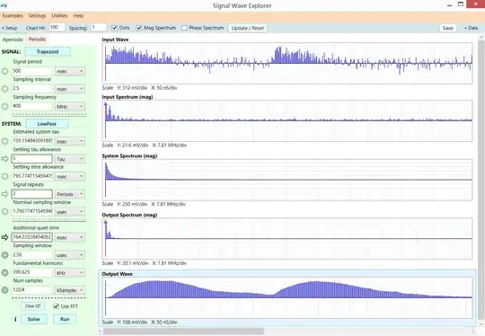

Here is a fast pulse into a slow filter, with NO NOISE. I used this setup, so you can see numerous lobes of sin(x)/x in "input spectrum(mag)". Notice the top button "phase spectrum" is not enabled; if it were enabled, we'd see 8 plots. This tool uses FFT computation, combining spectrum of input waveform with system spectrum to compute output spectrum (mag/phase), then using IFFT to compute output time waveform.
The Trise is 25 nanoseconds, Tfall 225, with 250nS deadtime until next pulse. The "system" is 1MHz RC LPF, thus Filter Tau is 1/6.28 = 160nanoseconds.
clean pulse
Now examine the pulse with +10dB SNR (noise bandwidth is out to the Nyquist rate). I'll show the SNR_control setup in 3rd PNG.
The output is much slower than input (Trise pulse is 25nS, Trise filter is 160) which reduces the amplitude from 1volt to 0.4 volt while greatly reducing the noise. For different noise waveforms, simply press "Run" another time; noise is randomly generated.
Compare the "input spectrum" to the "output spectrum" and notice the higher frequencies of "output" are cleaned up of noise.
 +10dB SNR pulse
And here is how you can adjust the SNR [the lower left "noise" box]
 input pulse description/setup
I used the RC LPF as example. Another choice is the LC (2_pole) with selectable dampening (Quality Factor).
Your fast-rise slow-fall pulse is the challenge. Most of your energy is slow. Here is setup for LC filter (Q of 1)
Here is pulse response for LC filter. For purpose of efficient FFT modeling (Signal Waveform Explorer uses FFT models of input waveform and of the system), I've used only small time separation of the pulses; your separation is 5,000uS, and your output waveforms will be separated.
Looks like 2MHz LC filter (Q=1) would be better....but your pulses are 5,000uS apart.
Notice the substantial delay of the LC (lowpassLRC in Signal Wave Explorer).
