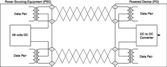

If you just ignore the POE 48 Volts in the image below, you can see Ethernet uses transformers on both sides.
This way there is no need for common ground as long as the common mode voltage stays below 1500V generally. The isolation specification of the transformers.
Imgur
And as a bonus you now also know how POE works. (802.3at)

    Your comment on CAT6A is incorrect. Shielding is not a property of the CAT specification. What you are referring to is FTP or STP. Additionally, you failed to the real answer is that differential signalling has better SNR than common ground signalling. – Aron May 04 '17 at 09:53

    @Jeroen3 it answers how to connect DC between Rx and Tx even though that's not how AVAYA does PoE ( I designed a PoE rack for them) It's is misleading to have so many newbies vote on this – Tony Stewart EE75 May 10 '17 at 05:53
  • @TonyStewart.EEsince'75 802.3at uses this method. Does AVAYA use something proprietary perhaps? – Jeroen3 May 10 '17 at 06:43

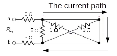

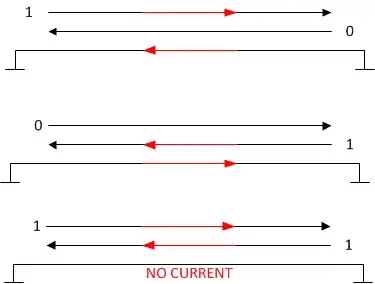

If you had a ground in between the transmitter and receiver it would create a ground loop. This ground loop would be formed by the cable and the return path would be mains ground as shown below. Any magnetic fields that flow through the loop would create a current along the cable (and the rest of the loop). Even if you isolated the signal wires this would be a problem because of mutual inductance between wires (wires run along side each other can couple currents from one to the other). This would inject noise (and cause potential bit error and packet loss).
So If you add an isolation transformer between devices, you break the loop and are still able to transmit a high speed signal between the transmitter and receiver. Another benefit of galvanic isolation, also increases the impedance of the cable to the device in the event of a large electrostatic discharge.
This is an example of isolation between two devices, ethernet has two isolation transformers, but the result is the same, it breaks the ground loop (and reduces common mode noise in conjunction with the twisted pair and common mode choke).
Images from wikipedia on ground loops

  • What is the practical meaning of the second scheme? I have never seen any ethernet cable with isolation transformer in the center ;) – mykhal May 04 '17 at 19:41
    It's an example, of isolation between two devices. – Voltage Spike May 04 '17 at 20:20

    Why not use two isolation transformers instead? One in C1 and the other in C2, like in reality. It shouldn't be more difficult to understand than a single transformer. – Oskar Skog May 06 '17 at 10:52
    I'll probably modify this one when I get time... But whether you have 1 or 2 transformers it doesn't matter if you want to break the ground loop. The secondary purpose is to provide isolation for ESD, so it helps to have one on each end. To break a ground loop you only need one. I chose this diagram because it has AC mains in it, and others did not – Voltage Spike May 06 '17 at 13:10
    @mykhal The second scheme is sometimes used in audio applications where a ground loop has formed between two devices and the resulting current has components in the audio band. Adding an isolation transformer temporarily outside of the devices breaks the ground loop circuit. – Todd Wilcox May 06 '17 at 13:10

More important is that for signal integrity and EMI reduction for egress and ingress, the signals are transmission lines with 75 Ω termination and balanced with CM transformer and 1:1 centre tapped transformer. This raises the CM impedance on the user side for isolation while maintaining the differential impedance on the cable side to local ground in the upper spectrum where signals exist.
See the "ground connections" below
  • via 1000pF coupling cap and 75 Ohm terminators enter image description here
  • CLEARLY , anyone that there is an AC ground for the Ethernet diff signals and without this it would fail as the CM noise levels of floating CM noise would be excessive even with CM choke with 100MHz~1GHz BW. Since the Terminators are AC grounded an earth ground is not needed, but there is a CM ground connection between connectors. So much for weak arguments of ground loops. These are not AC line loads currents! Why did everyone not understand this? (in the high scored answers). @laptop2d pls advise – Tony Stewart EE75 May 08 '17 at 06:14
  • ALthough OP asked about DC ground wire not included. It is not necessary since the current is shunted to AC ground via cap and thus the signals are in fact ground referenced at each end by definition Gnd = local 0V reference with low impedance to DC supply and AC ethernet common mode noise currents being shunted to local gnd to reduce EMI. and there is no need for AC line or DC shunting of noise as there is no signal here in lower spectrum. THis is critical to understand and not shown in any other answers. – Tony Stewart EE75 May 08 '17 at 18:50
