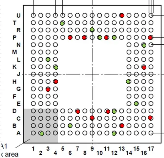

    Sometimes one cap per pair of power pins is used, even if the pins aren't right next to each other. This can simplify the layout and consume less area while still providing reasonable decoupling. – alex.forencich May 03 '17 at 18:22
    With that package where you can't actually get to the pins, I'm actually surprised there are not eight caps spread round it, esp since a lot of them are in the inside square. – Trevor_G May 03 '17 at 18:47
  • @Trevor Good point! It is TFBGA... – 71GA May 03 '17 at 19:36

As others have mentioned, it's likely they were only drawn that way because the designer decided they should have many caps due to the number of pins. They probably drew them as a group rather than assigning them because, looking at the power distribution on the device below, it would be rather hard to decide where to put them.
It's actually one of those cases where having some on the rear of the board makes a lot of sense.
Actually I am surprised there are only six of them.
