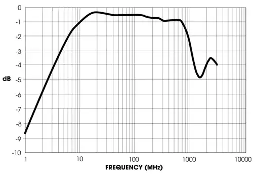

After a lot of searching, I think I have found a suitable transformer: Wideband Transformer with 2 Windings and Tap.
  • Turns ratio 1:1:1
  • 3dB Band Limits (MHz) : 4.5 - 1000
  • Loss at 20 MHz (dB) max : 0.7
SMT Transformer SMT Transformer 2 Frequency response
Added:
Just discovered that you can buy those from Mouser, and they are very expensive!

  • Thanks for that. Actually, after a lot of searching, I think I may have found a candidate transformer. Do you think this would be suitable. Please see my updated question. – Rocketmagnet Apr 19 '12 at 16:40
  • @Rocket: It looks reasonable at first glance, but I don't know the ethernet specification at that level. I have so far always used transformers specifically designed for ethernet use so never had to get into this detail. Like I said, it *looks* reasonable, but such things sometimes have unobvious gotchas. I don't know enough to answer the question definatively. – Olin Lathrop Apr 19 '12 at 19:49
  • Thanks, that's very helpful. I think what I'll do is make a little test board to sneak into the next batch of PCBs we make, so I can see if it works. – Rocketmagnet Apr 19 '12 at 20:13
