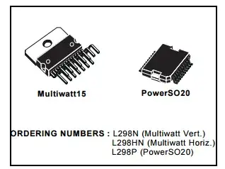

For an electronic part, always refer to the datasheet. Note that the link I gave is from ST Microelectronics, the manufacturer and not other alternative source (Sparkfun, Arduino forum, etc). Reliable source of information is important in engineering.
Right a the top of the datasheet, you will find this
L298 is the name of the circuit, but it does not refer to a orderable part number. L298N is a part you can order and it refers to the Multiwatt15 version of the L298.
