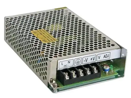

There are many articles on the internet about life expectancy of switching power supplies, but most of them have discussed about the situations that the PSU is at near full load. I'm designing an electronic device that needs a standby state, I'm using a COTS PSU with an output of 24V-5A, something like this:
PSU
My device power consumption is nearly like this:
5% of times at near full load.
55% of time at 20% of full load.
40% of time at standby (about 1% of full load).
I know that everything is depend on the quality of PSU and it's design specs, but Chinese suppliers doesn't provide enough and reliable information about their products. Although we are buying them from a sort of responsible supplier.
Can I generally expect of 10 years life of my PSU?
Someone says that the inputs capacitors (at high ac voltage) or the optocouplers regardless of the load consumption will destroy after some years. Is it true? If yes some other electronic systems like TVs that are on ac power for many years how had solved this problem?
