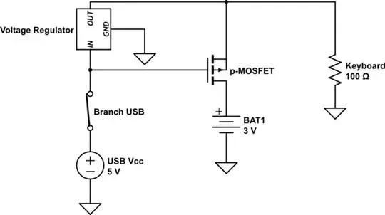

I have a wireless keyboard that I would like to power through a USB cord, I am not a fan of wireless, especially due to the battery use. I would however like to have the possibility of having the voice to use the batteries whenever I please. Now the keyboard is powered by 4AA batteries, judging by how they are positioned I am guessing placed in parallel 2x2. In order to power it I am planning to attach a micro-usb connector, and a voltage regulator to drop the voltage to 3.3V. I looked a bit around on how to create a switch which would disconnect the batteries whenever the USB is attached, and found several posts like this one: Automatically switching from battery to DC wall adapter on insertion however I am still confused as to what I should do. I tried simulating a circuit using a p-MOSFET:
While it appears to work when simulating it on http://www.falstad.com/circuit/, there is some back-current towards the battery. Also This seems like a bit too simple compared to other circuits I've seen around. Is this really a solution? I know there are some IC that can do power management, but they are a bit expensive for my taste, if I have to spend 10$ on it then I'd rather just cut off the battery part and go with the cabled solution. Thank you

    I doubt that the battery topology in your keyboard is 2P2S (2x2), parallel cell connection is never used in long-term applications. In RC toys maybe, but not for keyboards. Can you double check the actual working voltage (inside the device) before designing something based on wrong assumptions? – Ale..chenski Apr 30 '17 at 16:53
  • Hi Ali, thank you very much, I was indeed wrongly assuming they were in parallel. I suppose it still can be powered using the 5V on the usb, as it theoretically should have some leeway. But it does mean I would be passing from a Vgs of about -6V to -1V. – Nicolo Castro Apr 30 '17 at 20:01

  • Why is this easier than using a pMOS. I appreciate the compactness of the single IC, but from what I found it would make it more expensive, with little benefit right? – Nicolo Castro Apr 30 '17 at 16:55
  • Reliability. When there's an IC built specifically for the job you need, it's easier to use that and be sure it'll work well in the future than it is to use your own system that you're uncertain of. This also gives you the ability to limit current, and to manually switch the power source as well--you can switch to use the battery even if the power supply is plugged in, using the appropriate signals to D0 and D1. – Hearth Apr 30 '17 at 17:00
  • Thanks to the suggestion by Ali Chan I realised that I actually have 6V coming in from the batteries, and the power multiplexors like the one you suggested all have a operating voltage up to 5.5V, so I'm not sure they would work in my case. – Nicolo Castro May 01 '17 at 07:55
As mentioned, a mechanical relay is the second most simplest option, if you don't go with a manual switch or jack with a built in switch. The normally closed pole would go to the batteries. The normally open to the usb power. Also connect usb VCC to the relay coil. It will switch to USB when USB power is applied. Due to the small currents this would require, you could find some really tiny relays no problem.

  • Hi, thanks for the suggestion. It seems like a very good idea, also because the power multiplexors I found have a Vin 1.6V-5V, I think they might handle the 6V of the fully charged batteries but I'm not sure. Regarding the relays: is there any reason to prefer a mechanical to a solid state (apart from the fact that I appear to only find solid state relays for AC output). Finally, would a relay like a SRD-5VDC-SL-C do the job? Thanks for the help – Nicolo Castro May 01 '17 at 07:52
  • The mechanical relay is just easier imho. That relay would be fine, but a physically smaller one would be better. – Passerby May 01 '17 at 14:57
