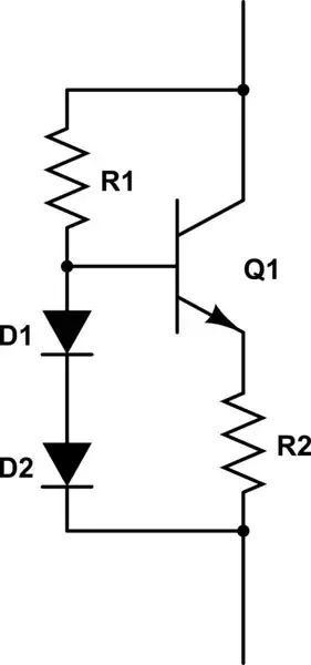

Regulation is not all that critical in this application, so you could probably use a reasonably high gain power transistor (not a darlington) and a couple of diodes (or 1 LED) as the regulator. You may have to adjust the resistors experimentally, depending on transistor gain, and the base-emitter junction and diode forward voltages.
R1 just has to be able to turn on transistor at low batt voltage (this current appears at the emitter) so for 400mA in the collector, the max R1 value will be a little less than $$ R_1 = \frac {(V_{BattLow} - V_{diodes})*transistor gain}{0.4} $$
R1 should be kept as high as poss without losing regulation at low batt. It needs to supply the transistor base current plus some to turn on the diodes enough to have a stable voltage across them.
It has more voltage across it at full batt voltage, so more current then flows through it. The extra current flows through the diodes, which hopefully hardly affects the voltage across them if they are already conducting well. Note that the voltage across R1 will be less if there is an additional voltage drop e.g. the 1 ohm series resistor (R2 in your circuit).
R2 sets the current limit. Use a resistor with enough power rating to run cool. $$R_2 = \frac {(V_{diodes} - V_{be})}{I_{lim}}$$
Diodes could be replaced with a suitable LED.

The idea is that the transistor base-emitter junction (a FET won't work here) has 0.7v across it, the diodes also have 0.7v across them so 2 in series gives about 1.4v. (1N4007s should work ok if they are biased on with enough current through R1).
This means the base is at a constant 1.4v above the bottom of R2 and the emitter is at 1 base-emitter drop less than this (1.4-0.7 = 0.7v) so R2 has a fairly constant 0.7v across it and therefore a constant current through it. This is most of the current passed by the circuit.
A much smaller current flows through the diodes, just to forward bias them into their constant voltage state, which adds to the current passed by the circuit but is usually small enough not to matter.
The higher the transistor gain the better it compensates for changes in applied voltage and the higher you can make R1. A gain of >50 would be good (e.g. BD639).
Most LEDs also have a reasonably constant forward bias voltage (roughly related to colour) of between about 1.7 to 3.5v (I've seen voltages outside this range). To check the on-voltage, use a resistor in series with a LED (or diode), adjust the voltage applied as you measure the current through it and voltage across it. Plot the results if you want to see the curve. Find the minimum current needed to get a fairly stable voltage as the current changes. You want a low on-voltage (< 2v, infra red or red have the lowest) so that you don't run out of head-room. Note that some LEDs are designed to run directly from a battery and do not regulate V in this way. If you can find a LED with a fairly stable and low on-voltage it could be used in place of the diodes. The brightness might even give you an idea of the state of charge. I have a feeling a LED on-voltage varies a bit more with current than a couple of diodes but I'm not sure. It might work ok.
Yes, good idea to use a variable power supply for testing the circuit between 4.2 and 3V. Ideally it should still be regulating well at the lowest voltage, which means you should probably leave out the 1 ohm resistor in series. Try it and see. Try different diodes and transistors and bias currents. (The best results will be if you find a LED or diodes for which varying the diode current has little effect on diode forward bias voltage and adjust R1 to give this current range).
You will probably need a small heat sink on the transistor.
The current can be measured anywhere in the discharge circuit where all of the current is flowing (between the batt and the rest of the circuit is good). Note that the voltage across R1 will be less if there is an additional voltage drop e.g. a series resistor (R2 in your circuit), but if you take this into account when calculating R1 so it doesn't drop out of regulation at low bat, it could be useful for measuring the discharge current. 0.1 ohm would drop 40mV at 400mA, easy to convert, but the your meter needs to be able to measure 40mV accurately to useful. 1 ohm is probably a bit too high for good regulation (only leaves 2.6v for the regulator at low bat).

  • To the OP: The reason I asked if you have diodes transistors etc, is that I was going to suggest you try this circuit. Basically, D1 and D2 become a voltage reference. Q1 is an emitter follower. So the voltage across R2 is mostly constant, and the current, therefore, is mostly constant. You will still need to watch cell voltage and manually disconnect it to avoid over-discharge. – user57037 Apr 30 '17 at 16:38

  • Yes, test it with a variable supply if you have one. If you don't have a good ammeter, consider putting a low value resistor in series with the battery to use as a shunt. Measure the voltage across the resistor, then calculate the current using Ohm's law: I = V/R. – user57037 May 02 '17 at 04:38
