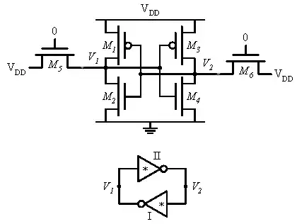

Four transistors is not bad to store a bit of data. If you would use a couple of gates you'd need at least 8. (A 2-input NAND gate consists of 4 transistors.) An SRAM cell is basically two inverters connected back to back, so that they one keeps the level of the other alive. One inverter consists of 2 transistors, so that's 4 in total.

  • Actually the cell you showed is a 6-transistor, because you count also the word-line ones. The 4-transistors cell uses pull-up resistors. – clabacchio Apr 18 '12 at 15:27

    @clabacchio - Correct, but in ICs resistors are [implemented as MOSFETs](http://www.cc.ntut.edu.tw/~vlsi/86-vlsi/Chap2/Ch24/IMG00001.GIF). But indeed there's a difference in the load's gate connection . – stevenvh Apr 18 '12 at 16:19
  • True, in fact I think that the resistor-transistor cell is not widely used in VLSI. – clabacchio Apr 18 '12 at 16:28

The basic CMOS inverter doesn't draw current (except for small leakage) when solidly in either state. This is a simple two-FET circuit. A PFET can pull high and a NFET pull low. The gates are tied together and the thresholds set so that only one of the two FETs will be on when the gates are fully high or fully low. However, a inverter doesn't provide positive gain. That can be solved by using two inverters back to back. Two inverters in a row make positive gain. If the two inverters are connected in a loop, then they have two stable states. One will be high and the other low, but the circuit is stable in both the high-low and low-high states. Since a CMOS inverter is just two FETs as described above, this memory cell is 4 FETs with the big advantage that it doesn't take any current when not switching. As Steven said, four CMOS FETs per bit isn't really all that bad. Everything is a tradeoff.

SRAM need 4 transistors in the smallest simplest design (resistor-transistor, but resistors are far bigger than transistors in MOS technology), 6 for a full MOS cell. You can have 1-transistor DRAM though, using a capacitor to store the value; but that's again dynamic logic, and it's the highest integration possible.

If one wishes to store a bit of information without significant ongoing power consumption, the most compact way to do that is to use two inverters, which will require an absolute minimum of four transistors to hold the data. Since holding information is generally only useful if one has a means of supplying it in the first place, an SRAM cell will add some additional logic to the four-transistor cell to allow access to it. To switch things "cleanly" without bus contention would require four additional transistors; in practice, it is generally possible to yield acceptable performance with two.
