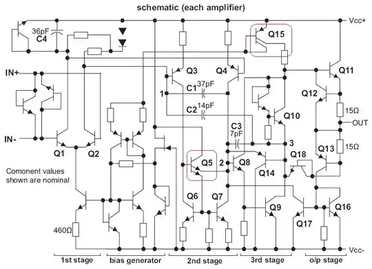

In a push-pull, or bridge amplifier both lines are driven as shown below. enter image description here enter image description here
Notice \$L-\$ is literally the inverse of \$L+\$
Similarly the other signal, \$R-\$ is the inverse of \$R+\$
The difference between the +/- voltages is that excites the speakers.
Now, if you connect Opposites to one speaker the difference in signal becomes the mixture of both signals. Hey-Presto.. you have a mono system.
Note however, the amplitude of each "Side" is now effectively reduced by half. If you can't understand that, consider the case where there is no signal on the \$R\$ side. The difference between the blue lines is now only half what is was between \$L+\$ and \$L-\$.
