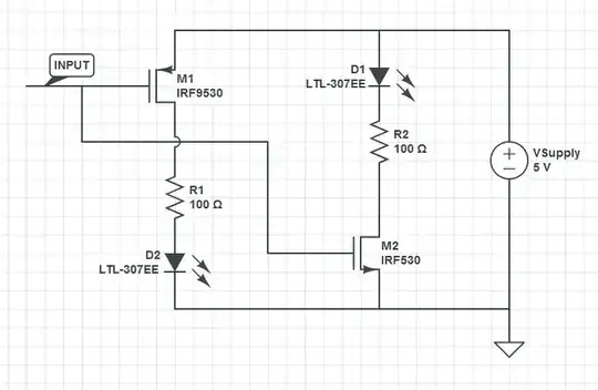

The problem is that you won't be able to turn on the NFET in your configuration. If your positive supply is 5V and your gate is 5V, then the NFET will always be in saturation. You need a large gate-source voltage for FETS to work like switches. Pulling the input of the FETs to 0V probably lights one of the LEDs, because the gate-source voltage of the PFET is 5V.
If these are two separate LEDs, then the easiest way to solve this is to separate the two circuits, and make one LED driven with the PFET, and the other LED driven with the NFET (see schematic below). This allows the best efficiency with the least number of parts.
This solution will work if you have separate LEDs:

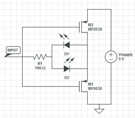

If it is an anti-parallel diode, there are still a few options. If the device driving the pin can source and sink the current needed, then you could use the two FETs to act as the opposing side of an H-bridge, as shown below.
If you have an extra pin that can drive the current needed, you could just hook the LED with resistor across two pins, and this would probably give you the simplest board design.

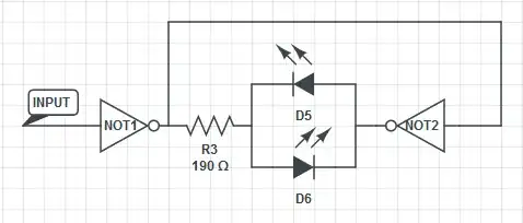

If you're not hooked on the idea of using discrete FETs, then you could consider a dual inverter chip, which would be cheap and easy to use, such as this part.
If you need to drive both LEDs to the same current (e.g. 20mA) then you will probably need a H-bridge to give you the flexibility of adding separate load resistors for each diode.

W5VO is right, the N-MOSFET doesn't turn on because \$V_{GS}\$ is too low; the gate may be at +5V, the source is nowhere near ground. Minimum changes will be to have P-MOSFETs both left and right, and drive one with the other's inverted drive signal. You'll need an extra MOSFET to invert the signal.
clabacchio's solution
is better, but like he says, has a bad static current through the resistors. If the LED voltage is 2V and M2 is on, the node R1/R2 will be at +2V. Current through R2 is then 2V/330\$\Omega\$ = 6mA. Current through R1 is 3V/330\$\Omega\$ = 9mA, so the LED current will only be 3mA, or half the current through R2. For higher LED voltages this gets even worse, and at a LED voltage of 2.5V there won't be any LED current at all.
Decreasing the resistors' values will increase the LED current, but the current through R2 will increase accordingly. This circuit will always have a low efficiency.
\$ \eta = \dfrac{(V_+ - 2 \cdot V_{LED}) \cdot V_{LED}}{(V_+ - V_{LED}) \cdot V_+} \$
That's for LED voltages lower than \$V_+\$/2. For higher LED voltages the LED won't light at all and \$\eta\$ will be zero. For \$V_+\$ = 5V and \$V_{LED}\$ = 2V this gives
\$ \eta = \dfrac{(5V - 2 \cdot 2V) \cdot 2V}{(5V - 2V) \cdot 5V} = 13\% ! \$
This is near the 15% efficiency of OP's circuit.
The solution is to switch off the current through R2 when M2 is on, and that's what an H-bridge does. Replace R2 by another n-MOSFET, and R1 by a P-MOSFET, and place a resistor in series with the LEDs (they can share it, only one is needed).
Of course this will double the number of MOSFETs, and you'll need an extra one to create a complement driving voltage. But it's the only solution to avoid the current losses.

As W5WO pointed, a solution can be a circuit like this:
Vdd is 5V, not 1V :) And the editor lacks the model for the BS250
This circuit should work, though it will have a static current on the two resistors (you may consider bigger ones). One of those will be overwhelmed by the respective transistor if its \$r_{DS}\$ is low enough. But it's a sub-optimal solution.
Remember that nMOS work better for pulling down, while pMOS are better as pull-ups. This because you need always a threshold voltage between gate and source.
If you have separate LEDs, it's better to use separate circuits.

  • Are you sure about this ... ? – MikeJ-UK Apr 18 '12 at 08:49
  • @MikeJ-UK right...wait... – clabacchio Apr 18 '12 at 08:59
  • @stevenvh yes, it was because I wanted to discard the circuit, but I settled for this solution; though, it has static current through the resistors. – clabacchio Apr 18 '12 at 09:12
  • That's better :) – MikeJ-UK Apr 18 '12 at 09:22
  • The static current is indeed bad. If M2 is on and your LEDs are 2V you'll have 6mA through R2, and only 3mA through the LED. If your LEDs are 2.5V they won't see any current at all! – stevenvh Apr 18 '12 at 09:35
  • @stevenvh indeed; depending on the application, 1k resistors may be better. But still, 2.5V LEDs won't work, as you say. But now I don't have better ideas without complicating the circuit. – clabacchio Apr 18 '12 at 09:50
  • No, 1k won't be better. The current through the resistor will remain double the LED's current, and that will even be lower (1mA versus 2mA through the resistor). – stevenvh Apr 18 '12 at 10:03
