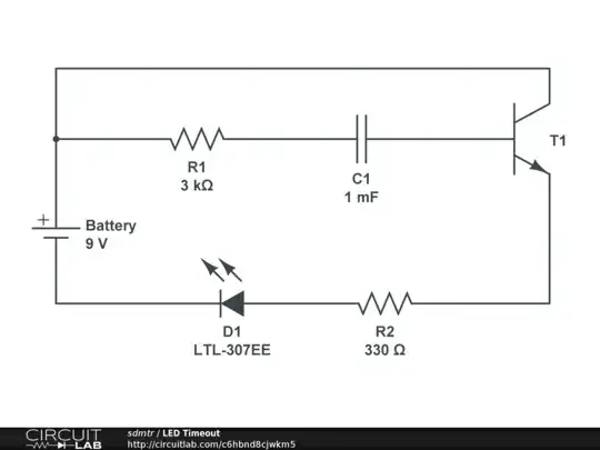

So, let's say I have this circuit:
CircuitLab Schematic 6hbnd8cjwkm5
Supposing the capacitor is fully discharged when the battery is first connected, would the LED light and then switch off after about 15 seconds? Here's my reasoning, and my (extremely ignorant and naive) expectation of how the circuit will flow:
  • When the battery is connected, current flows through R1 into C1, charging C1
  • 5RC = 5 * 3000 * 0.001 = 15, so C2 should take 15 seconds to charge up
  • During that time, current is flowing into the base of T1, allowing current to flow between the collector and emitter, thus powering the LED
  • When C1 is fully charged, current stops flowing into the base of T1, therefore current stops flowing between the collector and emitter, therefore the LED switches off.
Have I fundamentally misunderstood how capacitors work in DC circuits, and perhaps how transistors work too? If so, how could this circuit be reworked to produce the outcome I'm expecting (i.e, a circuit which uses a capacitor and a transistor to automatically switch off an LED after some period of time)?

    Your circuit is so confused I'm not even sure exactly what you don't understand. Two thoughts: 1. Connecting the cathode of the LED to the most positive supply voltage is almost never going to turn on the LED. 2. The base of the NPN BJT needs to be driven to a voltage above the emitter voltage to turn it on. – The Photon Apr 24 '17 at 16:28
  • Let's start with your first bullet point. Why do you think that turning on the battery would allow current to flow through R1 and C2, when they're connected to the battery only through a reverse-biased diode (D2) and a reverse-biased b-e junction? – The Photon Apr 24 '17 at 16:29
  • @ThePhoton I think the OP has the "little pointy things" mixed up in mind. Reverse the LED direction and substitute in a PNP. – jonk Apr 24 '17 at 16:42
  • In that case they should read [Which way to draw diode in a circuit diagram](https://electronics.stackexchange.com/q/31825/6334). – The Photon Apr 24 '17 at 16:45
  • @ThePhoton There is that point. ;) – jonk Apr 24 '17 at 16:49
  • Does current not flow from negative to positive? If it helps, perhaps you could imagine the LED was flipped around. – sdmtr Apr 24 '17 at 16:53
  • Conventional current (and you need to get used to this) follows Benjamin Franklin's first assumptions and so flows from + to -. He had a 50/50 change to get it right and... well... got it wrong (at least, when considering the usual case of electron flow.) So you are right, perhaps, if you are thinking about wires and electron flow. But we are forever now stuck with Benjamin's ideas about it a few hundred years ago. And there it is. – jonk Apr 24 '17 at 17:07
    Your circuit won't work, your explanation is therefore wrong, your commentary is fundamental to the questions you ask therefore, this cannot be answered. Voting to close as reason: unclear. – Andy aka Apr 24 '17 at 17:12
    I've just edited the circuit to follow conventional flow as best I can - again, I'm new to this, condescension isn't going to be particularly useful - and whether it works or not is entirely the point of the question: if it doesn't work, *why* doesn't it work? The commentary is an explanation of why I *believe*, wrongly or rightly, it should work, and isn't fundamental to the question of whether or not it actually would work and how it could be changed in order to work. – sdmtr Apr 24 '17 at 17:17
  • Your circuit will work as you said. If emitter initially is 4.5v, the LED gets 2v/0.3K = 6mA. The base gets 5v/3K = 1.5mA or plenty for beta as low as 4. You'll have beta of 100, thus LED current will be 12 or 18mA, and decline. Congrats with your thinking. – analogsystemsrf Apr 24 '17 at 17:50

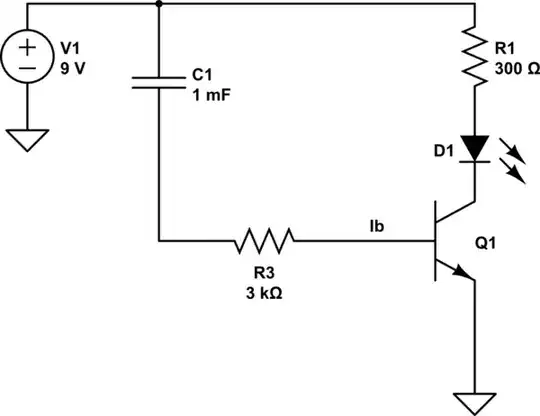

So many things wrong with that circuit, lets go back to the start.
The transistor is a valve that lets current flow through it from collector to emitter (the pointy arrow) when current is injected into the base.. as shown below.
As such, as long as you feed current into the base, current will flow through the transistor and, if the voltage on the base is high enough, it will act like a kind of switch.
When turned on, current can flow from the battery through the LED lighting it up. The LED can only withstand so much current or it will burn out. The resistor is included to limit that current to the rated amount specified by the manufacturer's specifications.
So now you have a circuit that will turn on an LED.
Now you need to drive that circuit with something that turns it on for a while, then turns it off. Now your idea is to do something like this.
simulate this circuit
Idea being C1 takes a while to charge up through the base limited by the resistor. Indeed with the indicated values the transistor will start to turn off around eight seconds after the power is applied.
Unfortunately a 1mF capacitor is rather physically large and expensive. The resistor choice also affects the current in the LED.
A better solution for this task is to use a different device like an N-Channel MOSFET.
A MOSFET is gated by voltage not current. This effectively decouples the timing side from the driving side. That means you can use much larger resistances, and therefor a smaller capacitor for timing without affecting the LED current.

  • Can you add why the FET makes a better choice? It's there, sorta, but it would be great if you finish the thought. Is it just that you don't have to worry about driving the FET to saturation, like the bipolar circuit? – Scott Seidman Apr 24 '17 at 17:53
  • Thank you, I think I understand. Incidentally, I edited my original circuit as you were writing this to make it fit conventional flow and to correct the polarity of the LED so I don't think you saw it before commenting - is my new version still wrong (putting aside for the moment the extraneous wires and amateurish layout)? – sdmtr Apr 24 '17 at 17:53
    @ScottSeidman.. done. – Trevor_G Apr 24 '17 at 18:00

Let's redraw the schematic. I think you either misunderstood the conventional direction of current or else how the diode is drawn (cathode and anode.) The reason I'm pretty sure you misunderstood something like that is because you otherwise got a reasoned description written out. So let's take your description and redraw the schematic.
Before I do that, there is something else you should immediately work on. And that's learning when to draw wires and when not to. Excess wiring often adds nothing to understanding a circuit, but adds "little black wires going from here to there" that can actually act to confuse rather than improve reading. And there is orientation. You may not understand this point right away, but tuck it away for later. If you just look at a schematic as a picture residing on a big sheet of paper, you want the current flow to go from top (more positive) to bottom (more negative) and you want signal flow to go from left (inputs) to right (outputs.) Broadly speaking, these rules work well to help communicate a schematic better than not following them. (Of course, there are corner cases or idiomatic expressions where the rules probably should be broken. But those are rare.)
  1. The battery and/or power supply isn't really needed because most of us can simply take note of a node voltage and make the right assumption about the intent. Besides, busing wires around just to show a supply rail and ground line connections is more for people who are wanting to wire up a circuit than for people who want to discuss how a circuit works. Different needs. It's distracting, besides. Though most learn to get past it quickly and get to the meat of the matter, with or without all that, it's still unnecessary.
  2. I've shown \$R_1\$ and \$C_2\$ with currents flowing on the sheet downward. I could have shown them horizontally, too. Whether one wants to look at this leg as being "signal" that should flow left to right, or as a circuit connection where current should flow top to bottom, is a matter of what you want to communicate, I suppose. But here I decided that we are not talking about "signal" but more about initial circuit conditions leading to later circuit conditions. So I show it this way.
  3. Note that I've taken it as granted that you still want to talk about a \$+9\:\textrm{V}\$ supply and that I needed to reverse the arrow directions, as it is the case today that the semiconductor PN junction arrow points from more positive to more negative, when active.
  4. I've used a PNP transistor to remain consistent with the rest.
Assuming the LED, when on, drops about \$2\:\textrm{V}\$ (red), and if the initial conditions for the capacitor are that there are zero volts across it, then, yes... \$R_1\$ will supply base current into the PNP transistor and pull it active. I'd expect a base current of about:
$$I_B\approx \frac{9\:\textrm{V}-2\:\textrm{V}-750\:\textrm{mV}}{3\:\textrm{k}\Omega+\left(\beta+1\right)\cdot 330\:\Omega}$$
If \$\beta\approx 200\$ then this suggests about \$90\:\mu\textrm{A}\$ of base current. Multiplied by \$\beta+1\$ to get the emitter current (in the hopes that the BJT is active and not yet saturated), I get an emitter current of about \$18\:\textrm{mA}\$. This suggests a drop of \$18\:\textrm{mA}\cdot 330\:\Omega\approx 6\:\textrm{V}\$ across \$R_2\$. So this means about \$9\:\textrm{V}-2\:\textrm{V}-6\:\textrm{V}=1\:\textrm{V}\$ on the emitter itself and that means that \$\vert V_{BE}\vert=1\:\textrm{V}\$ and that the BJT is actually still active and not yet saturated. So my assumption is born out and I can apply the \$\beta\$ I assumed earlier.
That is the initial condition. As the capacitor charges up, as you write, it acts to oppose the remaining voltage left available to supply base current (see the above equation and now also subtract the capacitor voltage in the numerator) and the collector current gradually diminishes over time, eventually becoming extinguished when the remaining voltage falls below the ability to keep the BJT active (usefully, when it falls below about \$550-600\:\textrm{mV}\$.)
The time period, or \$\tau\$, will be the value of the capacitor times the associated resistance. In this case, this resistance is "as seen" by the capacitor and it will include both resistors in this way: \$R_2\cdot\left(\beta+1\right)+R_1\$. So with your values and assuming \$\beta=200\$, then \$\tau=1\:\textrm{mF}\cdot\left(\left(\beta+1\right)\cdot R_2+R_1\right)\approx 70\:\textrm{s}\$. Which is pretty darned long.

    Unfortunately this is more of a dimmer than a switch though. – Trevor_G Apr 24 '17 at 17:40
  • Thank you, this is very comprehensive and I especially appreciate the notes on improving my layouts. – sdmtr Apr 24 '17 at 17:55
    @Trevor Yeah. It starts out kind of bright then just follows a long decay curve until it no longer works. (And that cap needs a way to be discharged, later.) I don't think the OP meant it to be a practical circuit. I think the OP meant it as a test of their ability to "think about things." – jonk Apr 24 '17 at 18:11

The original cct will work (its a simple emitter follower for who don'nt know) BUT as the cap cannot discharge for another cycle the LED will stay off until the power is removed and the cap self discharges due to leakage.
