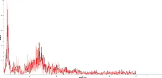

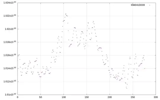

I collected the signal for 24h, in order to determine if there was any kind of correlation with the weather (like temperature vs hour etc.). Afterward, I plotted the number following the EXAN keyword in the received string (here in bold: CAL/I0M055D053#EXAN:15171500380:244/END).
Here 4 of the resulting graphs (x-axis represent the sample number, not time). Judge by yourself:
As you can see, every signal seems to behave differently from the others, without any apparent correlation with wheater (pressure, temperature...).
I would exclude any boat tracking system because I live in a mountain valley, at least 80km from the sea. Moreover, the source does not seem to move and the packets signatures are recurrent day after day (at least for the moment).
