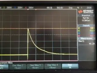

I measured the inrush with a scope (100VDC supply) and its a little over 40A, the theoretical max is over 60A but there is a reverse polarity protection diode and fuse and PCB trace and cap ESR reducing this.
Inrush measurement
That's the total inrush which passes through two resistors in parallel so approx 20A each resistor
As can be seen the surge has decreased to 50% of the peak after approximately 0.5ms so I believe I can treat this as a square wave with a width of 0.5ms as a decent approximation (like the EMC standards advise for TVS diodes etc)

If I did the integral right, the energy delivered into your R, by your RC circuit, is the following function of time:
$$E_{decay}=\frac{V_0^2\cdot C}{2}\cdot \left(1-e^{-\cfrac{2\cdot t}{R\cdot C}}\right)$$
If this value exceeds \$E_{limit}\$ at any time, you might have a problem. Given that you are measuring up to \$40\:\textrm{A}\$, I'm going to say that your \$V_0=132\:\textrm{V}\$ for the above purposes. So if you look at the case for \$t=100\:\mu\textrm{s}\$, you get \$\approx 462\:\textrm{mJ}\$ which exceeds the rating curve you have. To be safe, you'd probably want to be substantially under it, I think. Not over.
The curve does indicate that, given a little more time, there should be enough time and therefore no remaining problems. But this does seem to suggest a corner case problem when using a single device.
I gather you are using two of them and still having problems. (I'm not sure how all this is mounted and that could also be important.) In any case, if you plug in the \$1.65\:\Omega\$ paired-resistor equivalent, you get \$812\:\textrm{mJ}\$ for both. Which, divided between the two still exceeds the spec (by only a little.)
Just an added note because I had to make a correction to the first equation above, for \$t\lt 100\:\mu\textrm{s}\$. I had just made it a constant before, but it really is a function of time. Less time? Less delivered energy. The curve's flat line there makes that apparent. I'd just failed to account for it in the equation.
So with the correction, you can more easily see that for an even smaller period of time, say \$t=10\:\mu\textrm{s}\$, that the \$E_{decay}\$ equation supplies (using my \$V_0=132\:\textrm{V}\$ figure based on the \$40\:\textrm{A}\$ you had written) for about \$100\:\textrm{mJ}\$ of energy into \$1.65\:\Omega\$. But \$4000\:\textrm{W}\cdot 10\:\mu\textrm{s}=40\:\textrm{mJ}\$ as a limit by the curve. So the curve is far exceeded when considering shorter times like this. Even using \$V_0=100\:\textrm{V}\$, I get \$60\:\textrm{mJ}\$ of energy in that short time. So, still exceeds the specification.

Your energy is 20 amps per resistor (2 Rs in parallel, each 3.3) for 0.5milliSec. What is the Joules? P = I^2 &* R = 20 * 20 * 3.3 * 0.0005 sec, or 1320 joules/second * 0.0005 = 0.65 joules.
Now divide 650 milliJoules / 1.6 milliJoule (for a 1milliMeter cube volume) and the rise in temperature is 400 degreeC. Solder melts; aluminum creeps.
