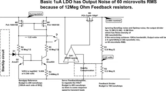

Lets also examine an LDO, providing regulated 2.5 volt output for any Vunreg over 2.7 volts, with standby current < 1uA per the datasheet. What do we know about the output noise of that LDO?
We know this LDO has at least 60 microvolts RMS output noise, because of the 12Million Ohms (times 2) feedback resistors. At least 60uV, because the internal opamp has high noise (at very low currents, expect high noise) and the 1.22 volt BandGap has high value resistors.
I recall an LDO, with 1uA Iddq, showing poor PSRR above 100Hz. Turns out the Vin metallization was above the 12Meg Ohm voltage dividers. Any trash coming into the LDO was directly injected into the servo-amplifier loop. Learn to visualize these problems. The original designer stated "the parasitic extraction did not show this as a problem." Learn to visualize these problems.
