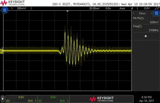

stage 1 opamp output (LTC6269) and corresponding LVDS output are shown, which have satisfied me initially, but below response is one i see frequently, some kind of repeating reflections or noise are seen close to the pulse
view 1 :
view 2 :
view 3 :
I have initially thought these may be noise, but as they are repeating I have not understood what exactly are they.
soon I have understood that these repetitive noises are present in the function generator output at low levels, but I don't know what caused this, did my 1K series resistor to TIA has caused these?
so I suspected my setup, now I tried to place the actual diode in place of the current source, which have shown no results at all, i have seen noise even with out any light source illuminated, which is undesired,so i removed the diode, when i power the circuit even with out input i get a output as below with a repetetion
is it because of improper grounding ?? or any low frequnecy noise ??
please help me in finding the root cause of the problem

output of opamp and ground, both auto scaled show similar noise pattern(green is signal ground), may be due to non isolation of Analog signal ground and power supply ground ?

  • It looks like something is generating noise after the initial pulse, and since it is in synch with the original signal it must be related. When does that comparator switch relative to the initial signal? If it's not at that moment, what else is beyond that that does? – Trevor_G Apr 19 '17 at 16:41

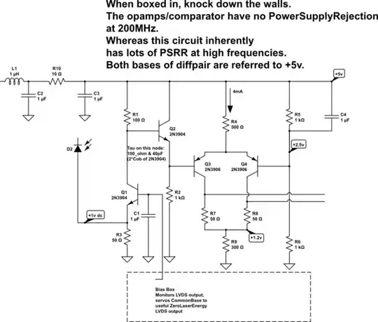

Such a healthy aggressive interferer: 200MHz ringing. On VDD.
The OpAmps and Comparators will have 0dB PSRR at 200MHz. The reactance of bypass capacitor: cap internal ESL + PCB vias + PCB traces ~~ 5nH, is j6.3 ohms.
You may need X2Y.com 4-terminal capacitors, ~~ 0.5nH installed.
Try this
The PI networks were repeated at the Sensor (2 meters away). For dampening, use R = sqrt(L/C) 0.3 Ohms; thus some inductor/bead R is useful.
NOTE: The GND/RTN path is also broken. We want to implement "local batteries" at the low-noise analog electronics.
COMMENTS ARE VERY WELCOME. Is this overkill?

Your power source is a switching regulator. Each time its internal switch turns off (or maybe on), these high frequency oscillations are generated and they are coupling by some means into your signal path (or possibly just into your scope input).
Eliminating them likely requires a wholesale re-think of your power management plan, and/or changes to your PCB layout.
Edit
The fact your scope measures (some of) this ring when probing the ground net (and presumably with the probe's ground pin also connected to the same net in your circuit) indicates that part of what you're measuring is signal coupled (typically magnetically) from your circuit to the probe, not necessarily signal that is present in the output of your op-amp.
You can minimize this effect by probing the circuit using the shortest possible ground connection between the circuit and the scope probe. An old answer of mine shows examples of some different probes, indicating which ones are bad and which ones are better.
Also pay attention to the orientation of the loop formed by the probe and its ground lead; you might be able to turn it a certain way to reduce this effect.

  • dont know whether my observation is right, i observed the RT of LT8471 is 187k, which results in a switching freq of 500Khz and my output noise also seems of same frequency, can i confirm form these ? – kakeh Apr 21 '17 at 03:25
  • It does confirm. But the noise you see is absolutely typical of switching regulator noise. I would have been shocked if you did not find the repetition rate of the noise equal to your regulator's switching frequency. – The Photon Apr 21 '17 at 04:02

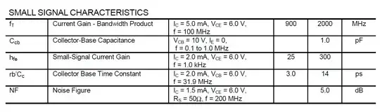

Tempting to consider this? The opamps/comparator have no PSRR at 200MHz. This circuit inherently has lots of PSRR; both bases of the diffpair are referred to +5v. To respond to 2nanoSecond Trise pulses, you'll need faster transistors than 2N3904/2N3906.
Here are some specs for the ONNN Semi NPN MMBT5179 package SOT-23, rated 900MHz---2,000MHz. enter image description here
