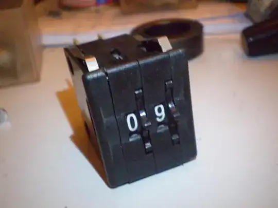

Thumbwheel encoders? These range from 0 to 9, are stackable and have binary outputs:
Thumbwheel encoders
peter
  • 484
    Is this really smaller than an SMD DIP-switch? – pipe Apr 19 '17 at 16:45
  • Ouch, no. It's about as big as my inability to read a simple question... Please vote as you see fit. Sorry for wasting your time. – peter Apr 20 '17 at 09:50
