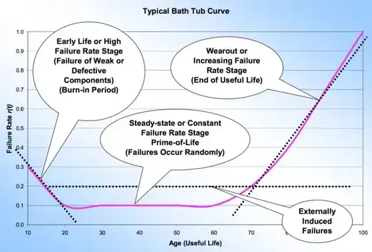

  • Bath tub curve: a curve describing how failure rate changes along the useful life of the component/assembly/product. See image below.

Bath tube curve
Image source.
