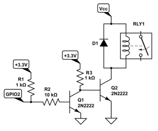

What you want to do is to connect your GPIO2 to the relay with this circuit. This will allow GPIO2 to pull up to near 3.3V at the power-on time but not click the relay. Then when the software in the MCU is ready to activate the relay have it output a '0' to the GPIO2 pin. The R1/R2 resistor pair have to be sized in ratio as shown so that the GPIO2 can actually be pulled high. (The circuit in the other answer has these backwards and does not allow GPIO2 to get to anywhere near to a valid high).

  • I will try this soon. So the double transistors basically 'invert' the GPIO signal? In the sense that GPIO going low causes Q1 to cut off which means Q2 saturates? Or am I misunderstanding? – arcologies Apr 18 '17 at 01:09
  • You are understanding exactly. The extra transistor inverts the signal from the GPIO so that the power-on condition with the pullup acts as the inactive relay state. – Michael Karas Apr 18 '17 at 06:08
  • I breadboarded the circuit. Boot works fine, but I can't get the relay to switch - does the fact that Vcc on the relay = +3.3v make Q2 not work properly...? – arcologies Apr 18 '17 at 06:15

  • @MichaelKaras I really like this circuit, since I have the same problem as OP. But I don’t understand it - could you please tell me, why Q1 „inverts“ the input signal? So why saturates Q2 when Q1 cuts off? Best thanks! – alve89 Jan 04 '21 at 04:23
    @alve89 - Q1 inverts because when the GPIO is high it turns on Q1 and the collector of Q1 will go to a low near GND. In the opposite state when the GPIO is low the Q1 turns off and the collector is pulled up to via R3. Since the base of Q2 is directly connected to the collector of Q1 the voltage at bottom of R3 will not achieve what is normally considered to be a "high" voltage level; ie the Q2 base-emitter junction clamps the voltage to somewhere around 0.7V to 0.8V. (continued) – Michael Karas Jan 04 '21 at 04:42
  • (continued from above) None the less the swing of the Q1 collector between near GND and the clamped "high" level is more than suitable for turning Q2 on and off. – Michael Karas Jan 04 '21 at 04:42
