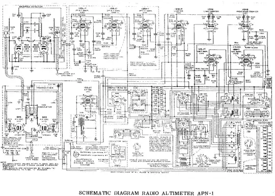

A Doppler RADAR using RF operating at a few hundred MHz - possibly using a Gunn door opener module from days of yore, can have a range of 'very large'. I once owned an APN1 Radio Altimeter from a Bristol Freighter (aircraft) and it managed 1000's of feet with ground as the 'reflector' - lots of ground admittedly - and used acorn tube thermionic valves. You should be able to get as much range as your heart may desire using RF.

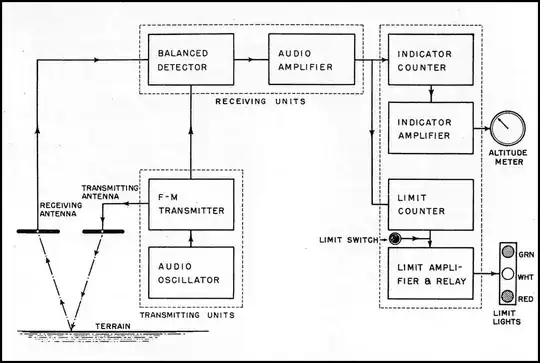

The APN 1 used a simple but useful method to NOT have to measure time of flight explicitly. Time of Flight (TOF) measurement is possible but at short ranges involves VERY short times. A nanosecond is a light-foot time wise!.
The APN1 transmitter was frequency swept and the received reflected signal was mixed with the current transmitted signal. The returning signal wis at the tx freq when the signal left and the tx freq has been swept to some other frequency by the tome the signal returns. The difference frequmcy, obtained buy mixing tx and reflected signal, gives a direct measure of range.
Discussion - while this relates to WW2 RF equipment it is directly applicable to a modern short range version
Basic principle:
Yee Ha!!!

I included the APN1 main circuit diagram as much for fun to show what could be done in 1940 with Acorn tubes BUT in gact it is potentially useful for ideas. The diagram above is readable if you look at it full size as supplied. (Right click and then copy or save or open).This is "as supplied" quality -somebody has scanned the original to a gif in 2 colour "black & white".

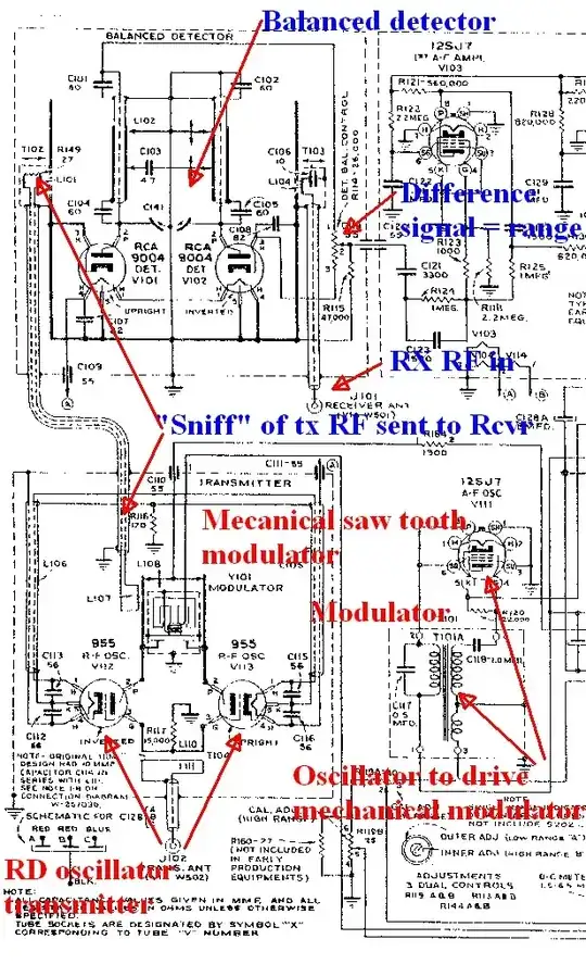

I have copied part of the circuit below and added notes. Something like this could be done with modern components with "relative ease" [tm].
The key special magic is provided by the modulator - here a voice coild driven variable capacitor wihich scans the transmitter across a frequency range. The modern equivalent is a varacror diode - variable capacitance with reverse voltage. The oscillator at right middle drives this modulator.
The transmitter is a pair of push-pull acorn tubes driving the transmit aerial at bottom left. A "sniff" [technical term :-) ] of RF is sent from the TX to the RX at top left. A balanced detector - here a pair of Acorn tubes V101 and V102 bu nowadays a Schottky diode ring mixer or similar take the TX sniff and the received echo and mix them to provide a difference signal at the output at top right. This is then amplified as the range signal. Implementing this with "solid state" parts would result in a simple and possibly even effective result. Transmitter beam width would be a major consideration. A GHZ or so oscillator and a lonnnnnng Pringles can antenna (or two) may be enough. Modern cellphone and WiFi components are so readily available (surplus if needs be) that the "hard" RF aspects could be covered by premade parts.

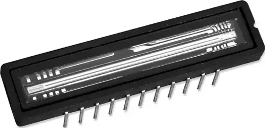

As Russell suggested it's possible to make your own laser rangefinder using angles. It depends how much work it's worth. They're tricky to build and make accurate, and by the end you might wish you'd just bought the Stanley one.
Basically, you shine a laser beam, then look at the spot with a little camera. Since this is a 1D application, you can actually use a linear CCD array, plus a lens to focus the image and an IR filter to help improve contrast.
Linear CCD
Start with the laser on, and take an image with the CCD. The CCD might be 1024 pixels wide. Store them in the Aduino's memory. Now switch the laser off, and take another image. As you read in the data for this image, subtract it from the stored image. If the CCD can see the laser spot, then you should be left with an image of the spot. Work out where the centre of the spot is from 0-1023.
Now you can see the problem. If your spot is perfectly focused, and covers only one pixel of the camera, the best accuracy you could get is 1mm over the range of 1.023m. This is probably no good for a tape measure. Your options are:
  1. Use a higher resolution CCD. I think they come in resolutions up to about 6000 pixels.
  2. Try to determine the centre of the spot to sub pixel accuracy.
